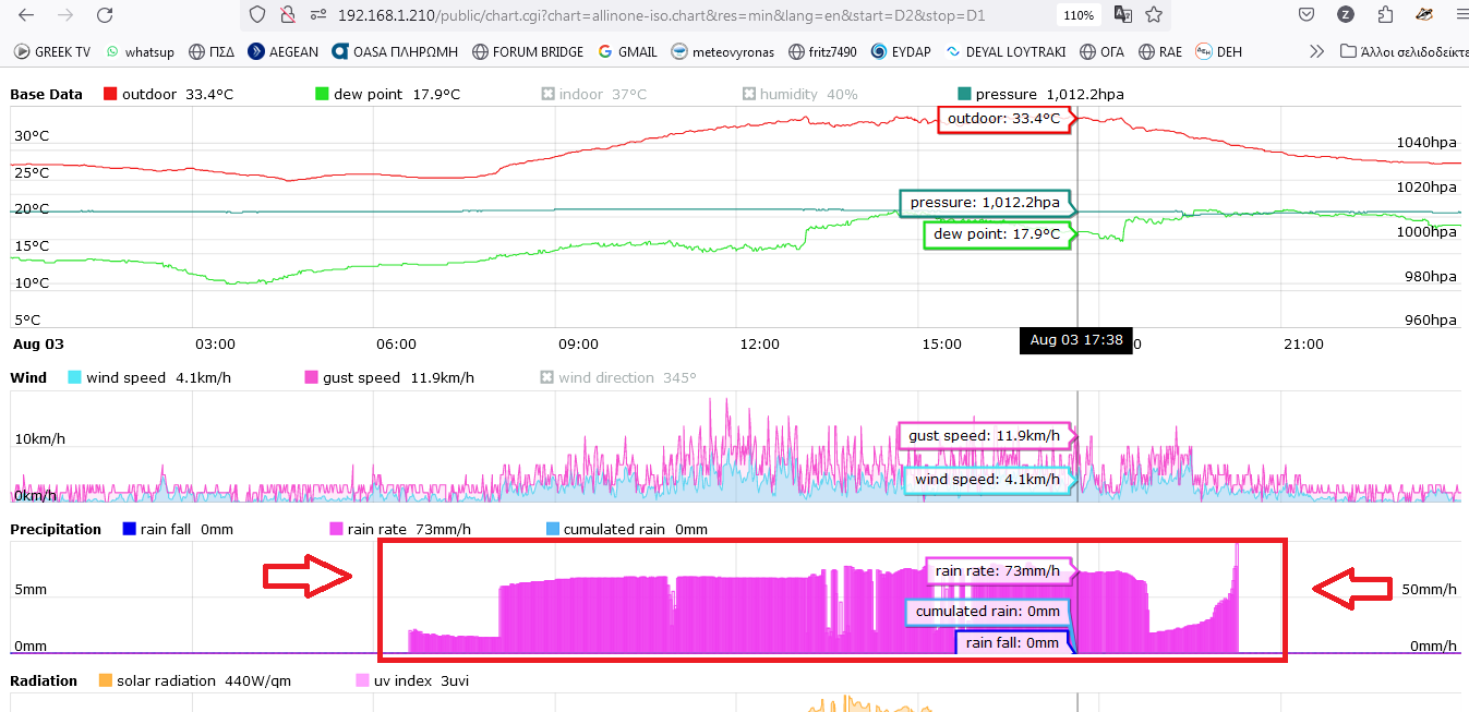

In the allinone.iso charts, in the rain rate section, the same image appears every day without it raining!
chart iso.png (140.04 KiB) Viewed 5468 times
This rain rate image is also transferred to all networks (underground etc.)
Unlike metacharts, the rain rate diagram is not displayed when there is no rain
Is there any setting that I need to make in meteobridge to solve this problem?

Do you also see the rainrate data in the database when you inspect? Which station are you using?
The is not rainrate data in the database!
Davis Vantage Pro 2 with Solar and UV sensor

The rain rate chart is the same every day and starts around at sunrise until sunset!
Re: Problem with the rain rate chart!
Theres is a definition for "solXrate" that you might have mixed with "rainXrate" on the mappings tab? Can you please post "Station - Mappings" tab?

You were right, I corrected the mapping and the problem was fixed.
