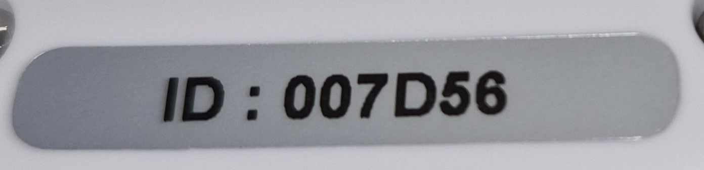

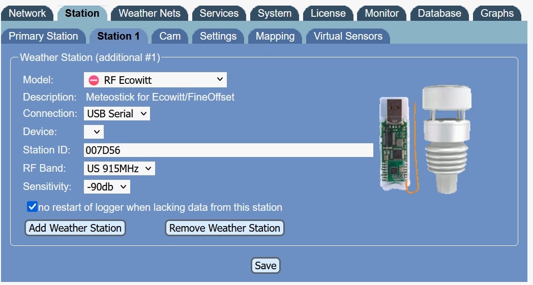

The Ambient Weather WS-5000 appears to be a rebranded Ecowitt WS80. I thought it might be possible to employ the Pro 2 with the station.
I set it up as follows:
Where the Station Id is shown as:

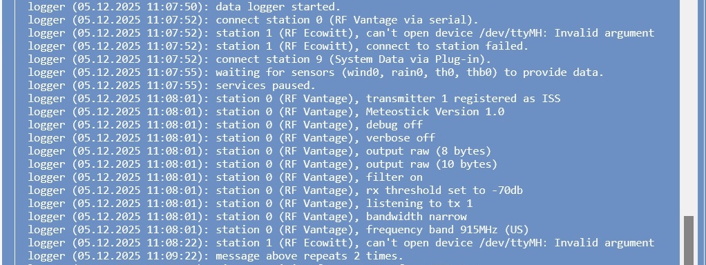

When the Weather Station is added, the log shows an error message of:
can't open device /dev/ttyMH: Invalid argument
Perhaps that indicates that the Station Id is incorrect? If so, what would be a valid Id?

did you try to use the ID without the leading zeros ?
And "Serial" instead of "USB Serial".
At the RF level the transmission protocol of the WS-5000-ARRAY should be the same as the WS80 as far as weather data are concerned.
An Ecowitt console can receive a WS-5000-ARRAY - then the SDR interface of Meteobridge should also be able to do this.

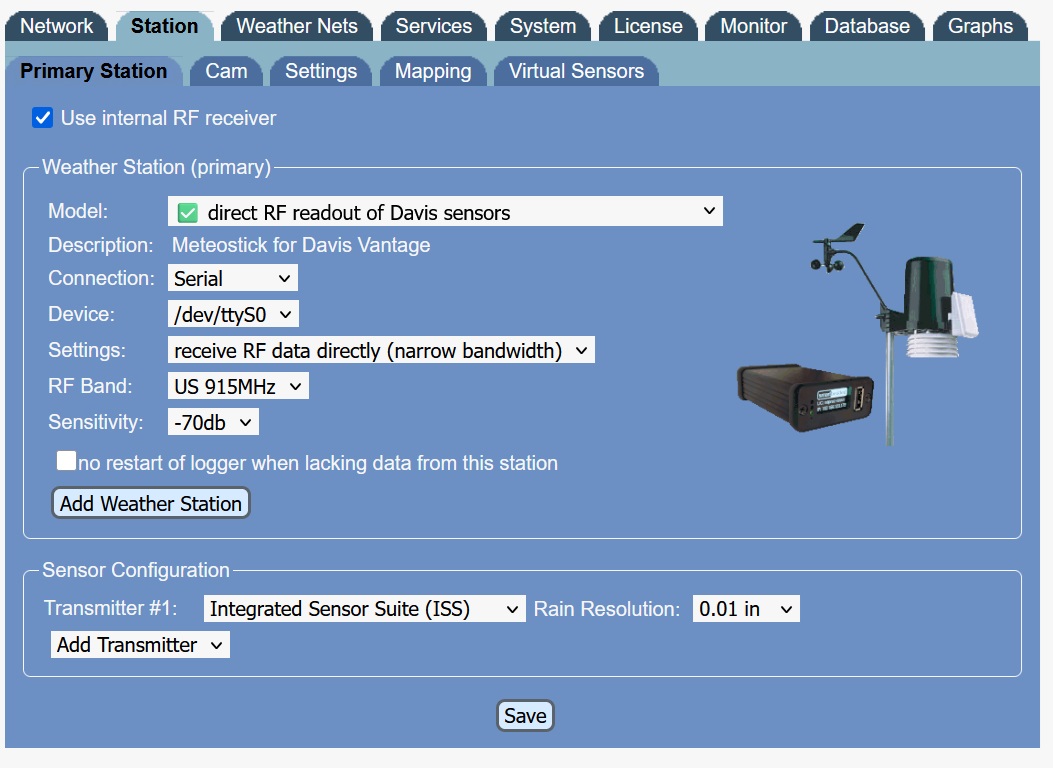

my station panel looks different ...
A Pro2 reads the RF signal directly without extra Meteostick hardware - as far as I understand it, it uses a Meteostick software emulation.
Your picture looks like a Pro or RPi or NANO device with an added Meteostick
Maybe your subject is incorrect and you don't have/use a Pro2 ...
Car54
Posts: 46
Joined: Tue Dec 22, 2020 4:57 am
Re: Pro 2 With AW WS-5000
Post by Car54 »
My primary weather station is shown above. The options for adding a station are different than for the primary station. There is no "direct RF readout of WS90/WS85/WS80/WS69 sensors" option. I picked the only option that is close. Perhaps this is an oversight?

that looks indeed strange ...
No idea why the picture is different.
Maybe, because the interface is already used by your Davis for Station 0 (primary) and the interface can only be used once at a time ....
Maybe some programming is missing for a 2nd station using this functionality.
Let's see what Boris (@admin) has to say here ...

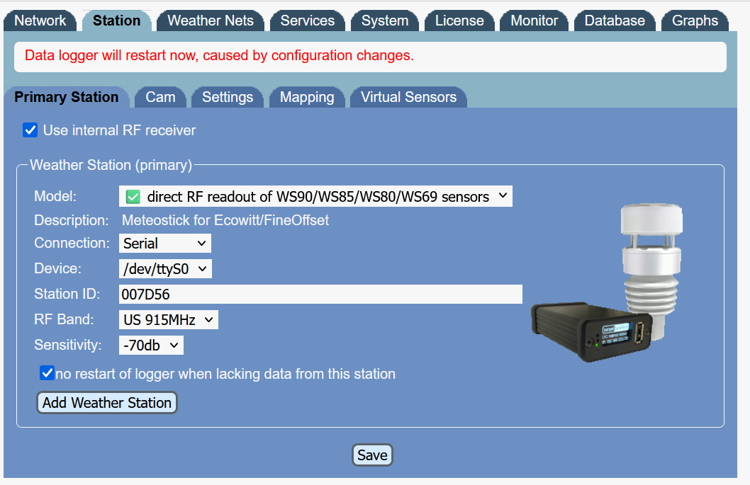

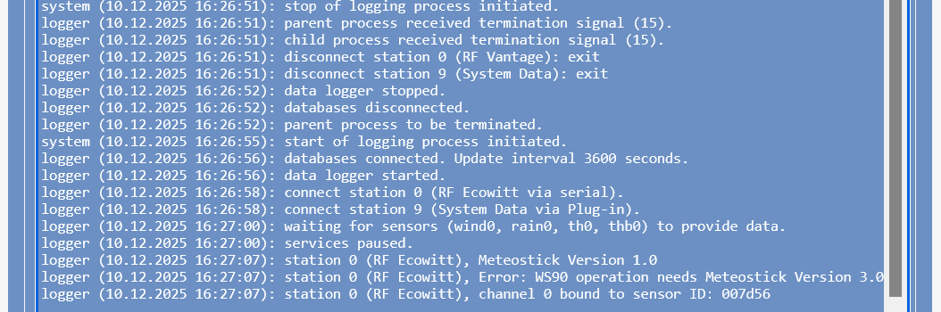

To test whether or not the WS-5000 will connect to the Pro2, I set it as the Primary Station. This generated an error in the log:
Error: WS90 operation needs Meteostick version 3.0
VP2+ Nano SD & Pro2

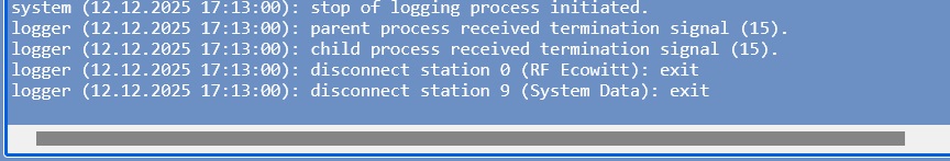

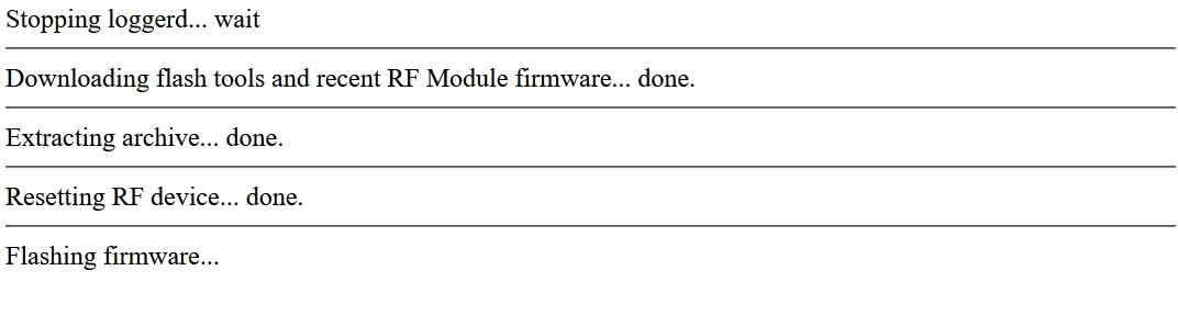

I had not updated the RF Module. When I tried, I received the following screen:
VP2+ Nano SD & Pro2
Gyvate
Posts: 458
Post by Gyvate »
and ... ?
starting the logger demon ...
can you use the RF "station" as station #0 (primary) - or did the firmware upgrade fail ?
If the latter, did you repeat it ?

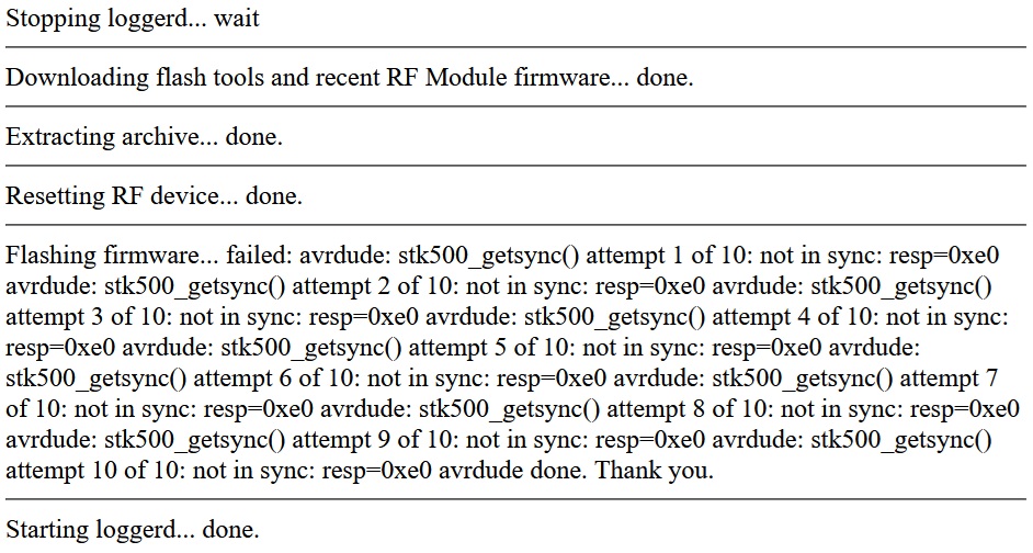

I tried the RF Module Update a 2nd time. It produced the screen and log file shown below. After waiting 10 minutes for the "Flashing firmware..." to append "done.", I gave up. I tried again to change the primary station to the WS80 and again the log file showed the same error:
Error: WS90 operation needs Meteostick Version 3.0 or newer!
VP2+ Nano SD & Pro2

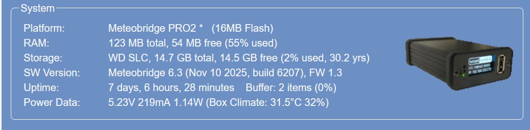

The Pro2 is running version 6.3

I think that's something Boris (@admin) has to look into himself.
Send him an email via info@smartbedded.com and give him access to your Meteobridge
username, password, MAC address
Refer to the post here - and we'll see what it gives ...
