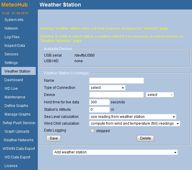

Thank you. I have been following this guide and everything seems to get hung up at the weather station page. I add a Davis Vantage Pro2. It shows available USB Serial and USB HID. However in the drop down menu for type of connection only USB serial is available. Should it not be USB HID?
When I select the serial option and complete the rest and click save it seems to hang with a transfering data message in the status bar.
The attachment is what I end up with after a save.
- weather-station.png (28.37 KiB) Viewed 4827 times

Success! The hang on the weather station page was confusing me. I stopped the browser after about 10 minutes and refreshed the page and all saved data remained. This then made the sensor page function properly and then it was clear sailing from there.
I'm now back in business. I used version 4.6n
