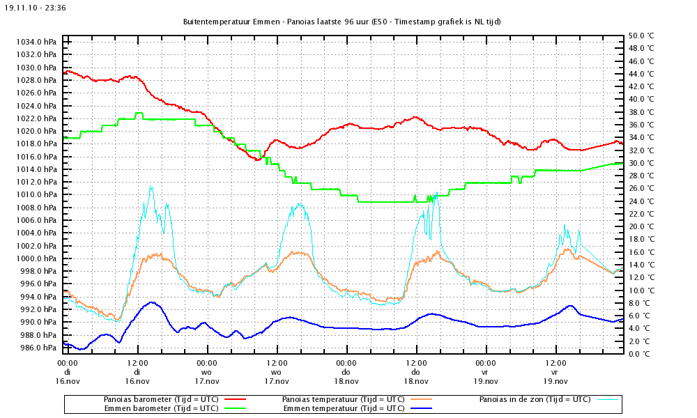

It's nice to have two weather stations in different country's, I use the data to compare the values and to make nice graphics. You can see the gap, this is the straight line, first part was the transfer of the system and the last hour or so was your gap.
Tomorrow I upgrade the system to the latest version and I let you know if it's working.
Temperature and barometer in two country's
