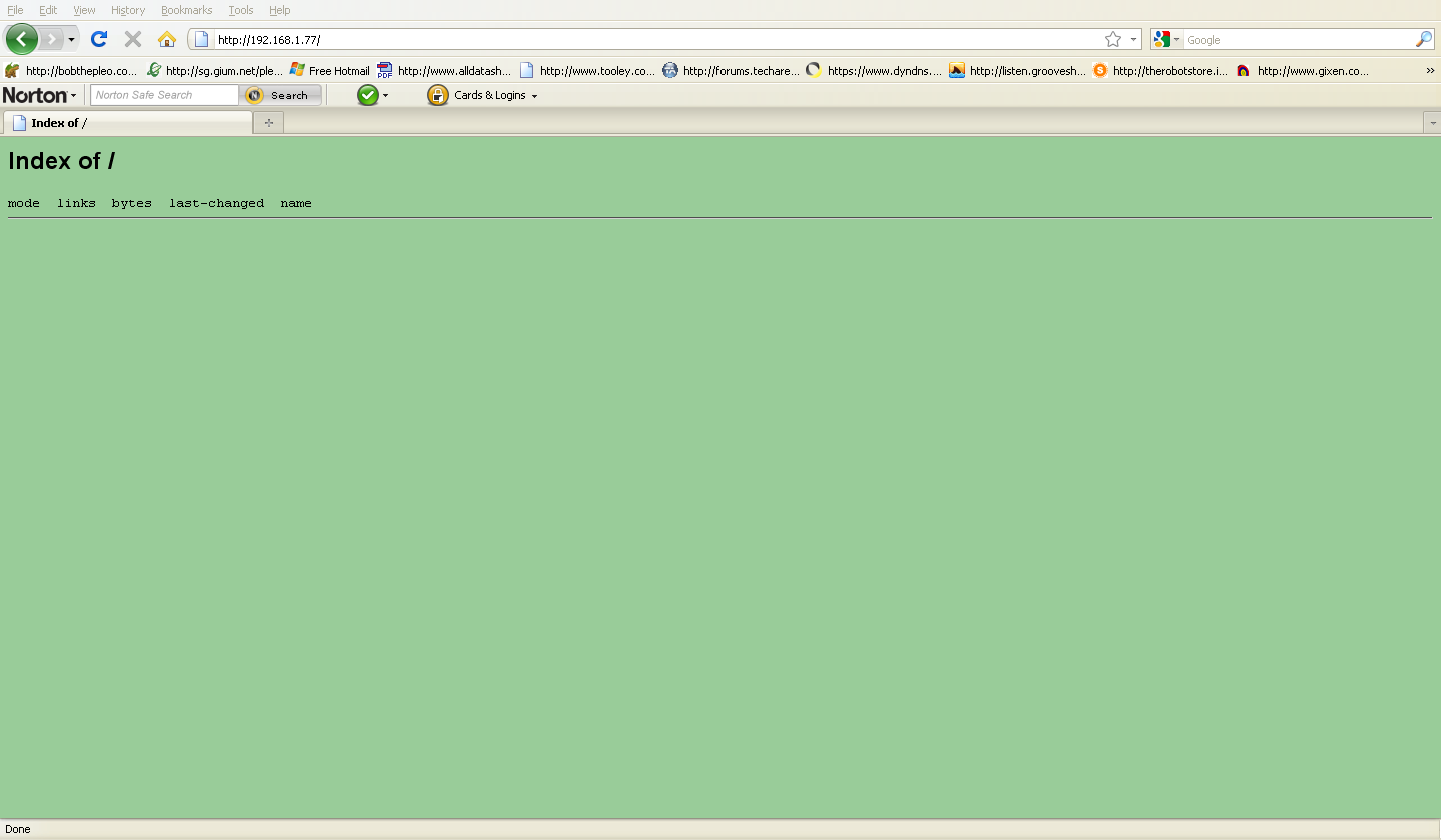

Having trouble logging into meteohub/RFXcom. Yesterday could not get in via 192.168.1.78, but I could get in via 192.168.1.77.
So I did a reset/recompute :?: :?: :?: .........today I cannot get in to either IP address. see on-screen login message........below. This screen is visible in IE or Mozilla Firefox
This is the screen when I try to log in, either by IE or Mozilla

I cannot reach the nslu2 via IE, I do get the same green page via Firefox though.

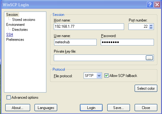

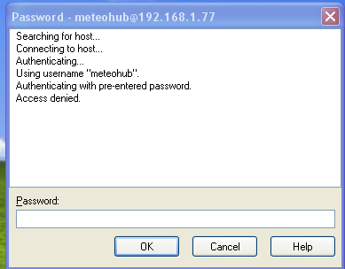

I have opened WinSCP and gone through to it using the username and password that is standard, It will let me in as far as the username, but will not accept the password. See snagit pictures attached.

After entering the password, I get an password/access denied warning.

you´re using the wrong login name
login name = root

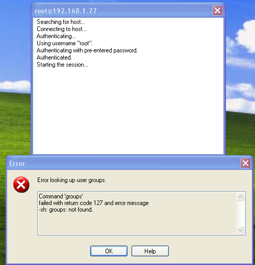

Ooops!! Anyway used root. Details attached
08-12-2010 10-46-18.png (53.53 KiB) Viewed 14108 times
There is something very wrong here. As I cannot get on via IE as I said. Nothing has changed on my system. WinXP SerPack 3.

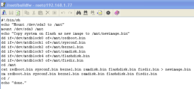

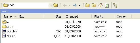

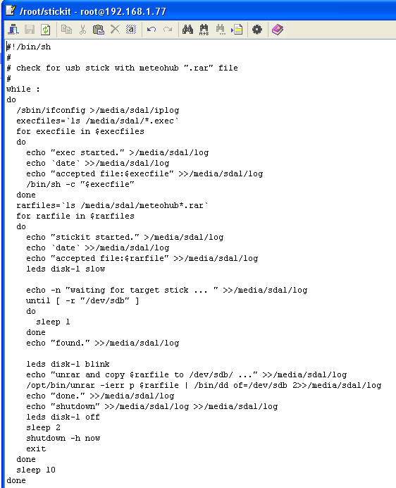

Just managed to get in, as I went to close winscp. Here are the results, not that I understand them. You may be able to shed some light for me "wfpost"
08-12-2010 10-55-15.png (12.69 KiB) Viewed 14108 times
08-12-2010 10-54-08.png (21.48 KiB) Viewed 14108 times
08-12-2010 10-53-17.png (5.64 KiB) Viewed 14108 times
YJB
Posts: 387
Re: Log in to NSLU2/Meteohub
Post by YJB »
Hmm,
The files that you are showing are from a brand new meteohub image. After you've copied the image (using rawwrite to a stick) meteohub will normally extract the files on the stick during the 1st boot cycle.
Apparently this doesn't happen with your setup, so apparently something goes wrong during this initial bootup.
- Are you sure that you've copied the stick according to the procedure?
- Could it be that you need to reflash your NSLU2, it might be that something is wrong in the onboard flash.

Just to go back for a refresh on my top post, this screen only appears when using Firefox Ver3.6.12 (Mozilla/5.0 (Windows; U; Windows NT 5.1; en-GB; rv:1.9.2.12) Gecko/20101026 Firefox/3.6.12 ( .NET CLR 3.5.30729))
I have now got my nslu2 working again, :D :D :D :D I re-loaded the firmware into the nslu2 using the "upgrade utility" and with the file "meteohub-firmware-2.3".
I am still using my original USB 4 GB key, :D :D with all my data on. It is at this moment re-computing. So all appears to be OK, apart from the use of Mozilla Firefox, which gives me this green screen above.
Has anybody come across this problem? :roll: :roll: :roll:
