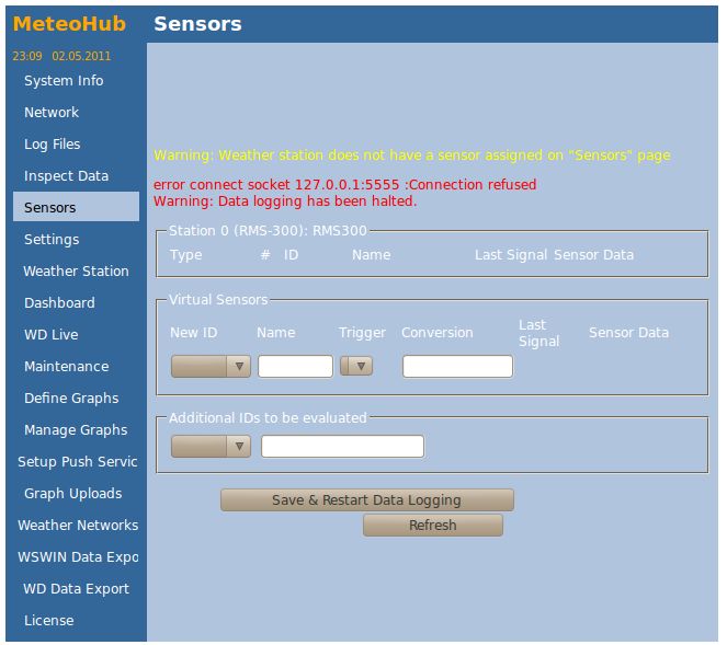

I just start configuration of Meteohub installed on NSLU2 and I am using RMS300 as a weather station with 3 wireless sensors (humidity and temperature).
But there's a problem with sensors connection.
Pictures will be better than large description so here are screen shots of meteohub :
Do you have an idea ?

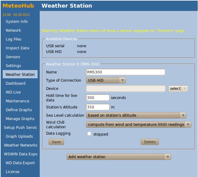

Re: No sensors assigned on RMS300
rms300 should detected as usb hid device. your second screen dump shows that this is not the case.
what does the dmesg log on log files screen say? the list of connected usb devices is the one i am looking for insight the log.

Oh that's strange because at the beginning was detected as usb hid device.
Apparently it dissapeared after RMS300 reset I did in order to retrieve sensors (I read somewhere that it coould be useful).
Nevertheless here is the dmesg log :

I am sorry my USB wire was not well plugged on my weather station and now I have something in "Weather station".
But I still have an issue with sensors because in "Sensors" page I have following message :
Warning: Weather station does not have a sensor assigned on "Sensors" page
error connect socket 127.0.0.1:5555 :Connection refused
Warning: Data logging has been halted.
And in 'Log files" I have this :
DMESG:

Please do a reboot and follow steps describen here: http://wiki.meteohub.de/Setup_Guide
stein42
Posts: 35
Joined: Fri Apr 29, 2011 11:06 am
Post by stein42 »
OK I just tried but it's exactly the same story.
Weather station is detected but not sensors...
Please browse to "http://ip-of-your-meteohub/cgi-bin/help.cgi".
This will give me a ssh tunnel to login to your meteohub.
stein42
Posts: 35
Post by stein42 »
That's done !!
nope, no result here. What does it print in your browser, when doing that?
stein42
Posts: 35
Post by stein42 »
open ssh tunnel to meteohub support
done
stein42
Posts: 35
Post by stein42 »
I had a bip on my NSLU2.
Apparently you are working on it !!
please update to 4.7f.
stein42
Posts: 35
Post by stein42 »
OK I will try I keep you informed
