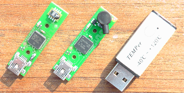

- Adds Vantage forecast texts in Italian (actual_thb?_fc_textit) and Dutch (actual_thb?_fc_textnl) to the list of variables. WD-Live feed will be supported with forecast texts based on language selection on "dashboard" page. Not supported languages will result in English texts.
- Supports Toradex USB OAK Sensors for Temp/hum and Pressure. Only one sensor of each type can be used. Each sensor has to be defined as a weather station, sensors need to be prepared before installation so that they do send data at regular intervals (at least once a minute). Still experimental
- Supports UK's MetOffice WOW network (still experimental)
- Some enhancements on backup/restore function. Indicates if there is a backup file to restore from and displays backup date.
- Supports cheap USB TEMPer devices as additional weather station type
- Supports setting of Vantage logger's recording interval fom "weather station" page.

Update to Meteohub V4.7i (NSLU2, x86, SheevaPlug, DreamPlug) brings these features:
- newdevices.jpg (150.75 KiB) Viewed 10143 times

is the Lux device also supported and would it write the correct LUX value into meteohubs database?
Oak USB Sensor Luminosity (LUX) (V1.2a)
http://www.toradex.com/de/En/Products/U ... Luminosity
Re: Update 4.7i
I also have a lux and a distance OAK sensor here, but I still struggle to get data from them.
Conversion from Lux to Wqm would be applied, assuming the it is a normal solar spectrum.
