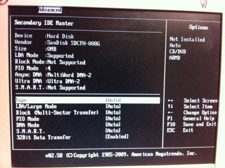

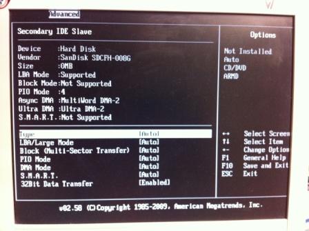

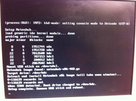

Re: 8GB SanDisk CF Card on an ebox 3310?
at first, thank you very much for your reply and your help!
The DIP Switch is set to "Master" and the CF-card is also recognized as the master drive. I try to use this SanDisk CF I 8GB card (http://cgi.ebay.de/kQ-CF-8-GB-Sandisk-C ... 549wt_1139 ). Perhaps you know, if this card works with the meteohub software and the ebox computer? Because I don't really know, which DMA modes are supported or where I could find this information.
The meteohub installer could mount the CF card as hdc drive. To show you what the installer exactly said, I attached three screenshots to this post. I hope they will help you a little bit to understand my problem...
Thank you very much for your support!
Akio
Initialization of the CF card looks fine. An ebox 3300 has been detected and boot is organized to use /dev/hdc.
Did you check all BIOS settings as lined out in Appendix L2?
You can see there that Meteohub expect the CF card to be secondary master (not slave).

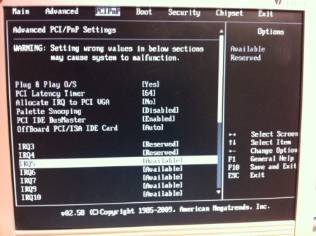

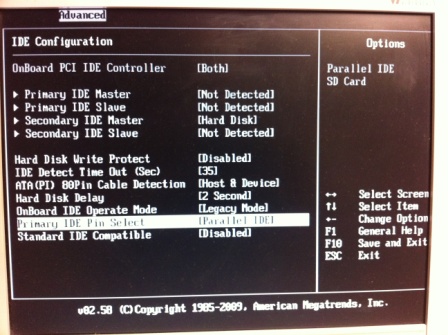

at first, thank you for your reply and your help!
Yes, I know that the CF card should be Secondary Master and my last screenshot was a little test, if there is a difference, when I change the DIP switch to Slave...
So, today I checked all BIOS settings with your supposed Appendix L2 settings, but I can't find any difference. Furthermore I uploaded the relevant BIOS screenshots of my ebox 3310. Perhaps you can find something...
Do I have to format the CF card before I install the meteohub software? And which format should I use? Or do you have any other idea? Is my CF card compatible?
Thank you very much!
Akio
