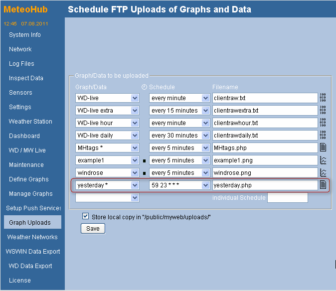

I've found a way to get-around the issue of not having full yesterday_ data by using a graph upload cron set for "59 23 * * *" to snapshot the day1_ tags and put them into yday_ tags .. seems to work ok and lets me have valid yesterday data for min/max and times
Best regards,
Ken
Code for yesterday.html template
Best regards,
Ken

Weather-Display names used in common scripts like ajax-dashboard.php and ajax-gizmo.php
This page runs via cron on Meteohub to capture the day1_ variables into new pseudo variables yday_
for capture and use of yesterday's full variables.

?>- Attachments
- 20110807_mh-yday.gif (21.15 KiB) Viewed 4770 times
