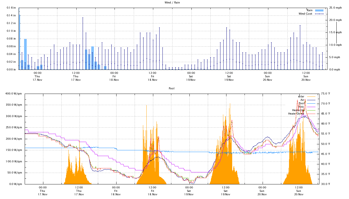

It is useful for solar data more accurate than homebuilt solar in a jar. I have a solar pool heater on the roof (out of commission for the season) that I have tweaked for performance. Pro 2 Plus was more expensive but I splurged for it anyway. Now I'm glad I did.
Actually, I'm glad I replaced the WMR200 for a number of technical reasons, including more reliability.
Last several days were sunny, except sun is lower to the horizon. In full summer, solid graphs upwards to 950W/qm.
Scroll graphic down for relevant portion.
