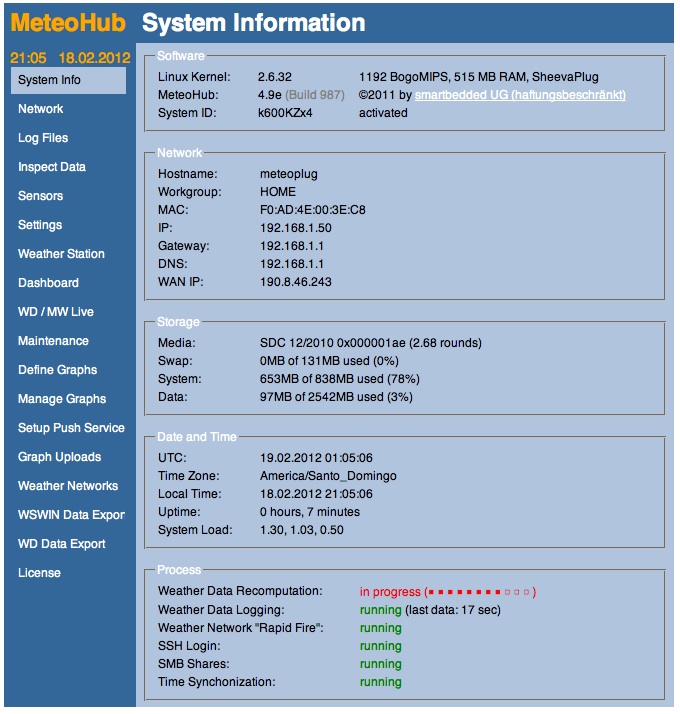

Thanks for your response I connected with my laptop to Meteohub via a browser and had to accept the LICENSE terms after loggin and then Meteohub did the 4.9e update from version 4.9d and started uploading to Wunderground http://www.wunderground.com/weatherstat ... =ISAMANAS2 but I am afraid that it wont keep logging after a while
In the SETTINGS/Meteohub Server window what parameters should I use

- my Meteohub System screen
- Meteohub System Screen.jpg (148.25 KiB) Viewed 8981 times

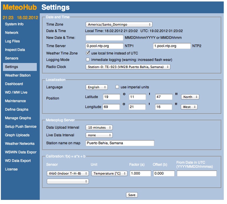

Are these intervals values correct for the 4.9e and the TE923 WS?
- My Meteohub Settings Screen
- Meteohub Settings Screen.jpg (152.38 KiB) Viewed 8981 times

1) Please deselect "radio clock" as you have an internet connect. ntp is much better. It also says so in the manual, btw.
2) WU rapid fire is about 10 seconds, but your weather station does only deliver data every minute, so don't worry about that. That has btw nothing to do with the live data uploads or Meteoplug server intervals your screen dump shows
3) Please let "data hold interval" at 300 or 600 seconds, otherwise your weather station data logger will be restarted again and again, when this timer is passed and no fresh data coming from the weather station. I don't know if this is part of your issue.
4) Why are you afraid it will stop sending updates to WU when it started fine? This normally works very stable unless misconfigured.
