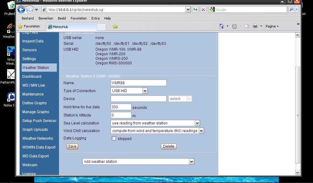

I do not have a blank field for sensor definition on sensor page.

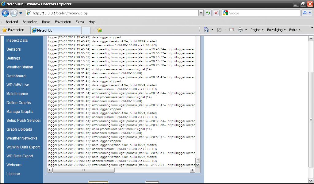

Mister Pasternak logs in my Meteohub 3D3 ALX3W and find that: the data coming in via USB show lots of read/init errors.
The weather station WMR88 is defined on meteohub log page, but I have no white stroke on sensor page under the weather station notifacation.
So I can not give the sensors an ID.

sensor page
sensor page
weather station page
weather station_ 24-05-2012.JPG (84.71 KiB) Viewed 21347 times
log file for WMR88
log file for WMR88
meteohub log.JPG (135.77 KiB) Viewed 21347 times
