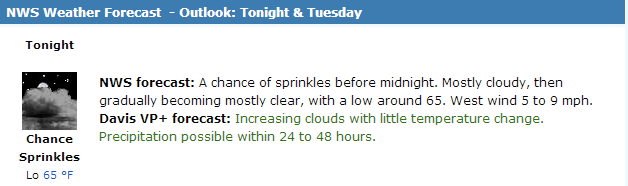

I'm using the Saratoga-Weather PHP scripts on my website, and it would be nice to display the Davis VP+ forecast below the NWS forecast, just as a reference. I use my website for myself primarily, and it displays US NWS forecasts currently... The console display message is available from WeatherLink 6.0.3 using WLIP, so I suspect that can also be pulled from the console as well.. I'd like to incorporate the console messages into my website, if at all possible (Especially today when the rainfall rate at my station was 0.52"/hour and the console was displaying "It's raining cats & dogs."admin wrote:Forcast messages are not reported so far. Most users don't trust these local forecast things a lot. There are better sources in the Internet for weather forecasts than the own local station in the garden, I guess

You can see the example of how the VP forecast message is incorporated into those scripts at his website: http://saratoga-weather.org/index.php

Thanks for adding this! I worked with Ken at Saratoga-Weather.org to get the forecast message added into the Meteobridge templates.. We discovered the UTF-8 encoding of some of the messages caused grief for PHP, so the templates were updated to only include the English versions -- but it works fine, and I've incorporated it into my page.admin wrote:ok, convinced. I will give it a shot with the next release cycle.
