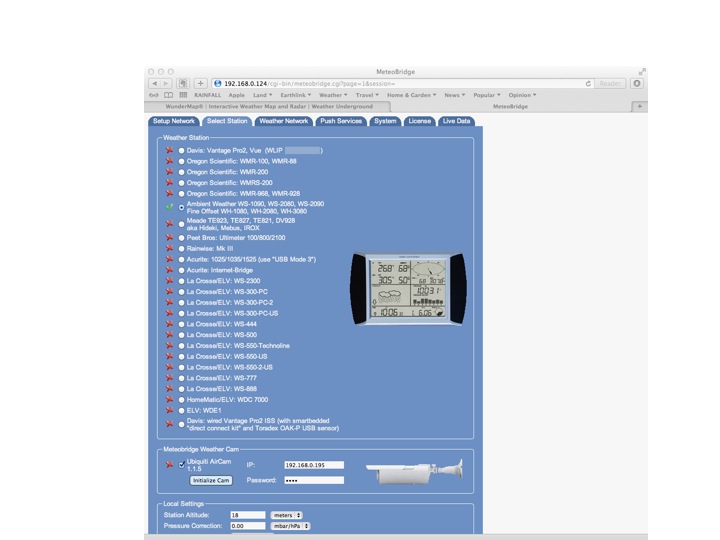

I switched browsers and could access meteobridge and went through setup again.
But Aircam initializes successfully but still have red X as before

Re: SUCCESSFUL AIRCAM INITIALIZATION BUT NO UPLOAD TO MB"
hi, I now could login and found the root cause.
It is a Aircam version 1.1.5. Up to now the init script could only handle 1.1 and 1.2.
I changed a few things so it now also reacts correctly on any 1.1.x version.

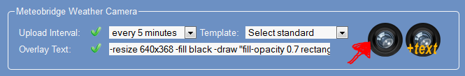

Did you read the wiki? There (http://meteobridge.com/wiki/index.php/W ... her_Camera) it says "When you click onto the left camera icon, you will be directed to the URL on the Meteobridge server, where the latest uploaded image is stored". How can I say it more clearly?
Click onto the lense icon pointed to by the red arrow (on your Meteobridge's "Weather Station" tab) and a browser window with the URL in its headline will show up.
