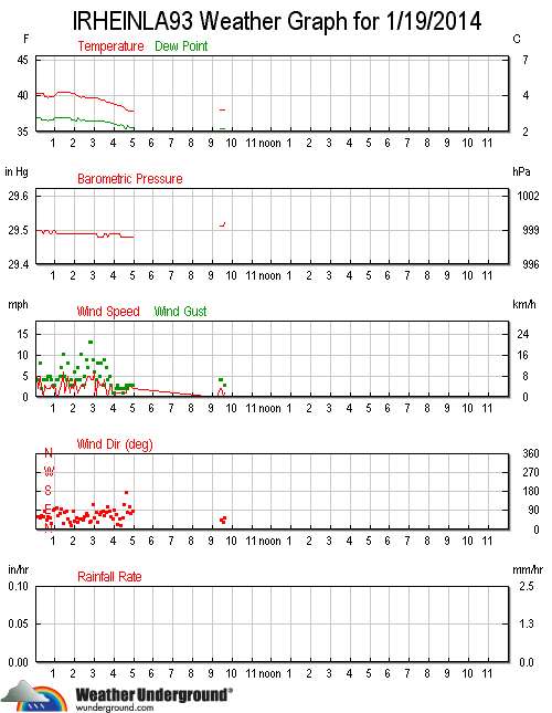

Hi !
the meteobridge stopps reporting as you can see at 5:00
At 9:30 I´ve resetted meteobridge, it worked for a few minutes and stopped again. As you can see, before 5:00 it worked fine.
The config is to transmit to Live each 30sec, to Clud 10min
Wunderground 5min
weatherbug 15min
wetter.com 5min
The meteobridge is installe on an TL-MR3020 and is connected via Lan and DHCP. My Network works fine, no other Problems

The errors look very much like a missing USB hub, where the serial connection
drops after a while. Do you have a USB hub in between?

No,
The Vantage Pro II is directly connected to the TL. As I think, the USB-Port of the Vantage should be USB2, is´nt it ?
I had an additional USB-Extension-Cable connected, that I have removed meanwhile. Perhaps it was the Problem.
Reiner
Posts: 7977
Re: Meteobridge stops Reporting to Weathernetworks
you need the usb hub. having it in between problems are gone. 100% for sure.
