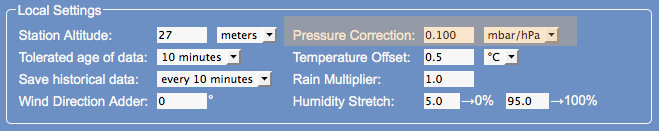

Re: ERROR: AcuRite 1035 Bad thb0(0) sensor data **solved**
What does live data tab tell about pressure?
Did you enter correct altitude on system tab?
Did you apply a pressure correction offset on westher station tab?
The learning feature for calibration of the pressure sensor of the accurite is a feature critized by many,
as results are often not that great. However, Meteobridge reads pure sensor data and correction
has to be done manually on the "weather station" tab of the Meteobridge.
Does message window on "System" tab show any issues regarding pressure?
