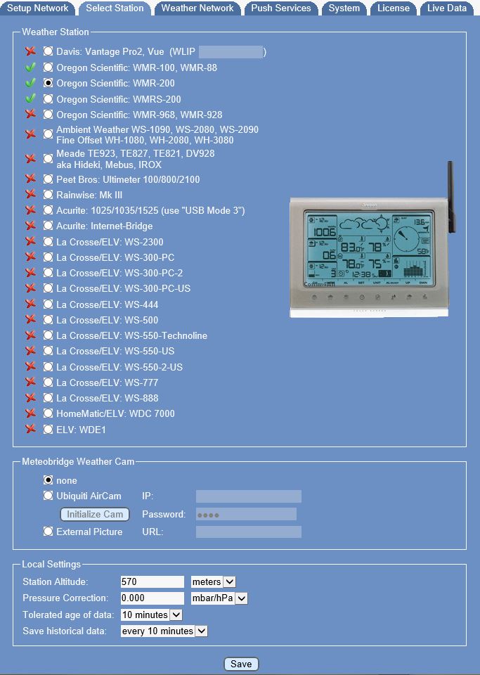

Re: WMR200 no data
yes it works with the WMR-200. Please provide a screen dump of your "weather station" tab.
dazza1033
