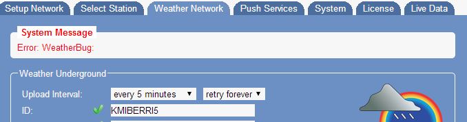

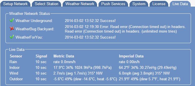

New MeteoBridge setup with the below details. Up until recently, it has been uploading data to all my weather networks. I noticed today there was apparently a new release (3345) recently and since that it seems it can't communicate with the WeatherBug network. The other two networks seem to be communicating well. Was there some change in the release 3345 that may cause communication issues with WeatherBug? :(

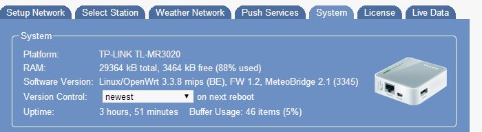

Platform: TP-LINK TL-MR3020
RAM: 29364 kB total, 3464 kB free (88% used)
Software Version: Linux/OpenWrt 3.3.8 mips (BE), FW 1.2, MeteoBridge 2.1 (3345)
Version Control: on next reboot
Uptime: 3 hours, 51 minutes Buffer Usage: 46 items (5%)

Time out problem indicates that there might be a server/connectivity problem at weatherbug?

There still is a problem with Weatherbug, as they need over 5 seconds to handle the data hand-over request from Meteobridge. I changed the code to allow for up to 10 seconds, but to be honest a better solution would be Weatherbug fixes this performance issue on their side.

To make things worse Weatherbug no longer supports the connection test feature that allows Meteobridge to check login credentials before sending payload data to Weatherbug. I asked them to reimplement this feature.
Until then, please ignore the red crosses on the Weather Station page, uploads go fine when credentials are right and you can check this on "Live Data" tab.
