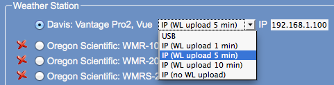

When you reboot the Meteobridge, latest update will give you an option to define Weather Link update frequency: every minute, every 5 minutes, every 10 minutes, never

Thanks Boris! It works like a charm! :)

Works fine!
