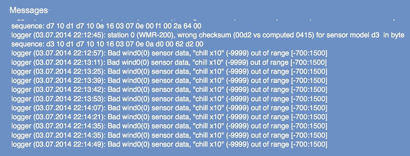

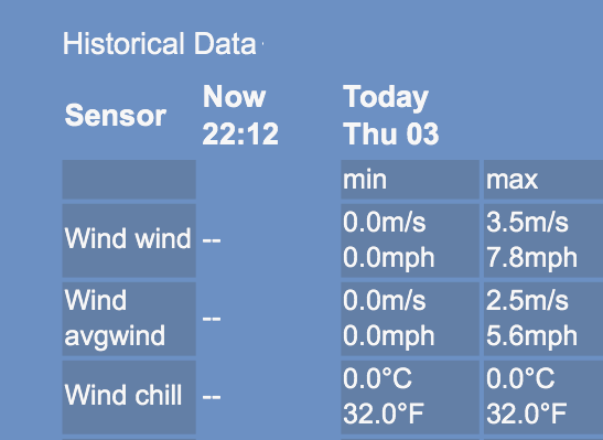

I have problems with my meteobridge on an MR3020 and station Oregon Scientific WMR200.
When I update to version 2.3 I have problems with the wind sensor. Unfortunately I have to go back to version 2.2 :( :( :( .

In order to log wind speed beside wind sensor data also data from primary temp outdoor sensor must be there, as this is needed for windchill calculation. When your WMR200 has reception problems with wind sensor and/or primary outdoor temp sensor, Meteobridge will behave as lined out in your screen dumps.
I am quite sure, that this is your problem, not version 2.3.

The temperature outside has no problems and is displayed correctly. I tried a bit 'of times is always the same. With version 2.3 I have this problem. With version 2.2 it works correctly. Now I'm back to version 2.2.
