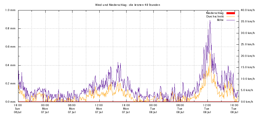

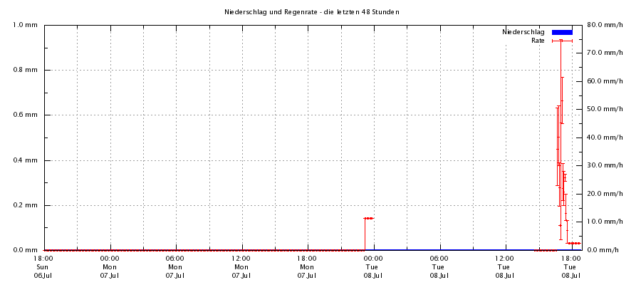

Since some time there are errors in recording rainfall.
In a typical event data comes in and then there is a lot of data following within seconds - and then there is a gap. It's possible to delete this data (a lot of data), afterwards rain/time works, but no cumulative rainfall.
Version 4y, 1 wmr200, 2 plugin-stations (collects data every 90 seconds).
rainfall errors
rainfall errors

Marking the data "deleted" did not solve the problem, as mentioned before.
Looking through my older posts I recognized a similarity in an older topic: the last value of the rain-sensor is 114442 - the same value as in an older post. I reset the wmr200 and the value started at zero again - problem solved.
