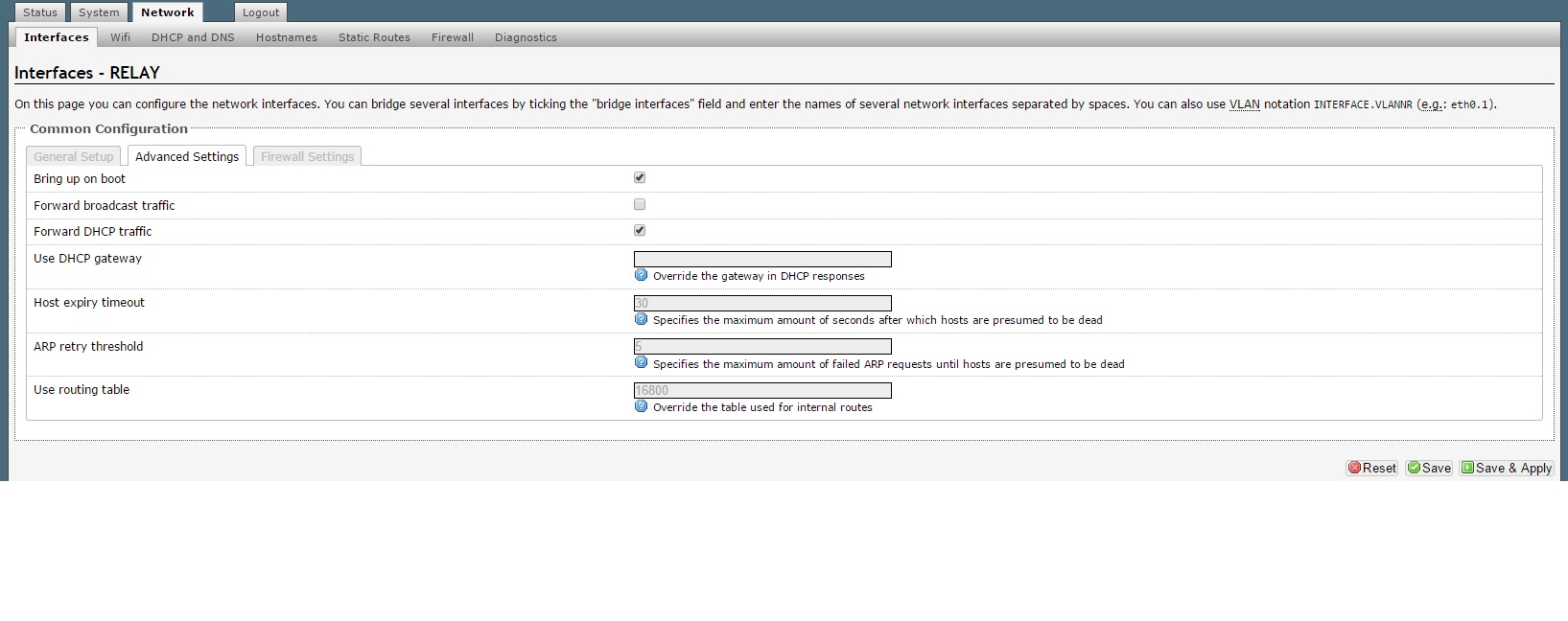

I have just set up a davis vantage pro 2 with weatherlink ip to my MeteoBridge. MeteoBridge is reading the data OK and all seems to be fine with it, howeever I cannot connect via WeatherLink when it is connected to the LAN port on the MeteoBridge. And I note that when I attempt a ping of the WeatherLink IP from my computer I get duplicate packet issues:
64 bytes from 192.168.0.30: icmp_seq=0 ttl=62 time=28.275 ms
64 bytes from 192.168.0.30: icmp_seq=0 ttl=62 time=29.272 ms (DUP!)
I also note that for some reason my router (Netear WNDR4000) thinks that the MeteoBridge has got the IP address of the WeatherLink IP - even though I connect to the MeteoBridge via its own IP address (192.168.0.130)
Any help appreciated.

Hi All,
In case anyone else gets this, I found that I have to turn off the forwarding of broadcast traffic for the Relay network device. - see attached.
This has resolved all my issues.
Peter.

I may have spoke too soon.
It worked fine for a while, but has failed again - lost contact with weather station - possibly when the DHCP on the WLIP expired.
This setting did however stop the DUP packets on ping.
Back to the drawing board.
