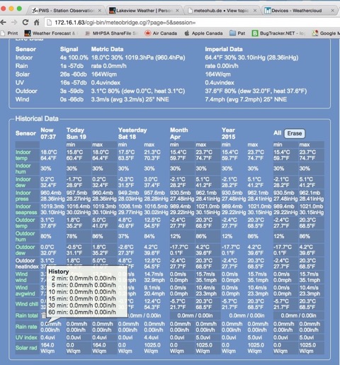

Here is the "live Data" tab that is indicating that the Metrostick appears to be reporting Rain Rate of ZERO. Correct?
I am starting to wonder if the issue is possibly on the WU web site side.

I think you are right. For today and yesterday the max value in Meteobridge historical data section shows 0.00 mm/h.

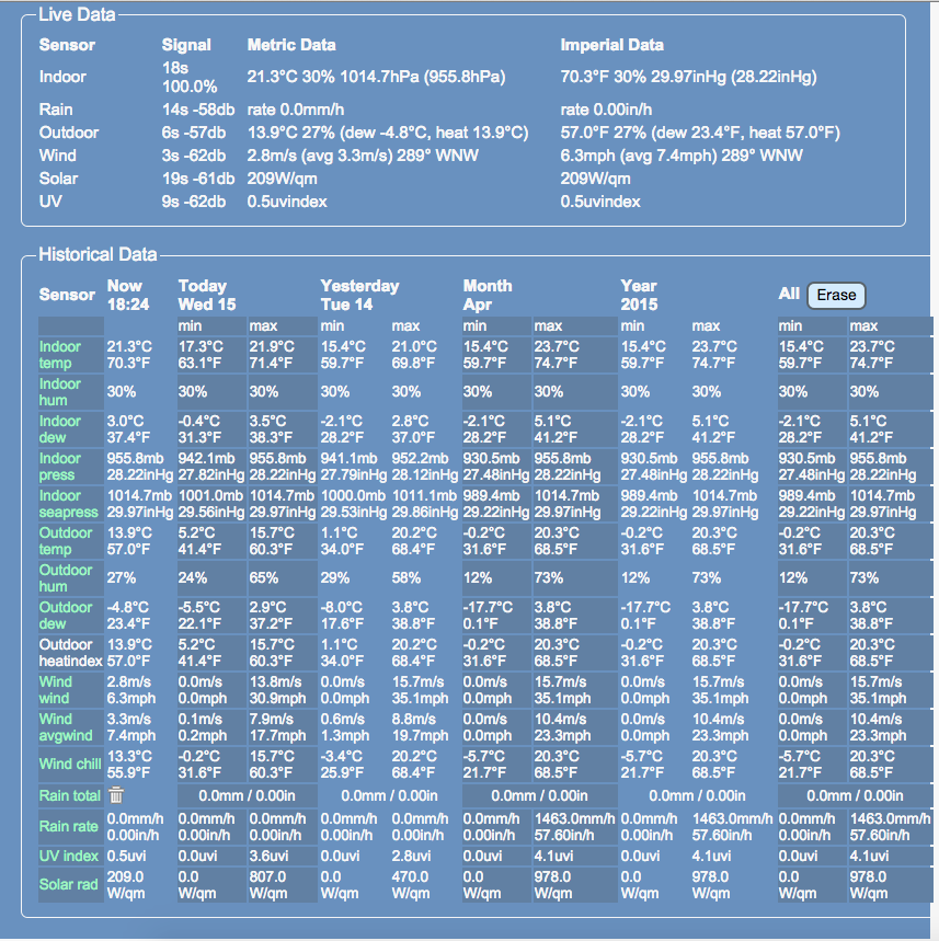

Here is a screenshot of the MeteoBridge LIVE DATA screen while the web sites are erroneously reporting a Rain Rate. You can see that the Live Data is showing zeros.

In your earlier screenshot, you can see the high rain rates in the max column for April and "Year 2015" (showing a huge value of 1463mm/h), although in your more recent screenshot, these values are 0 (were you able to clear them???)
