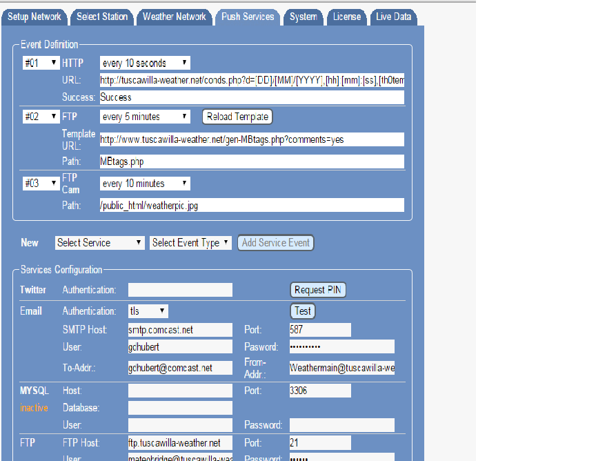

Could you please provide a screen dump of your "push services" tab?
In 2.4 the way how to specify push services has changed significantly.
I have some code in 2.4 that should migrate old settings automatically,
but may be that did not work 100% OK in your case.

Attached screen capture as requested.
Greg.
