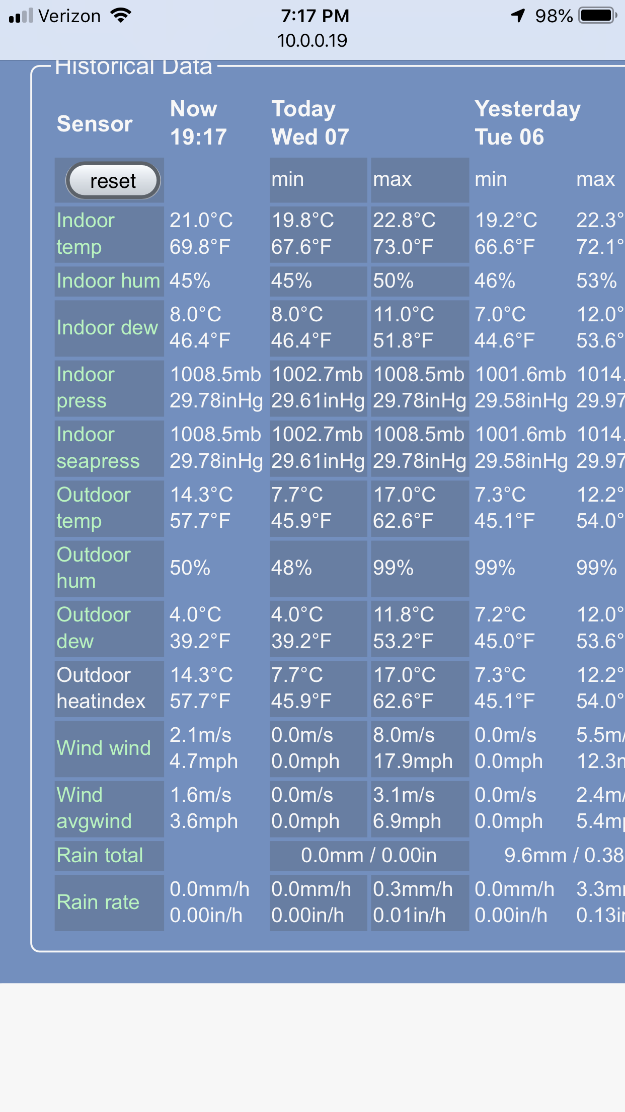

Hey everyone,
I have my WMR300A connected to Meteobridge with the USB hub. Everything seems to be working fine except wind chill data. Wind chill is not listed under historical data. Could this be a minor glitch or is it something that is not supported?

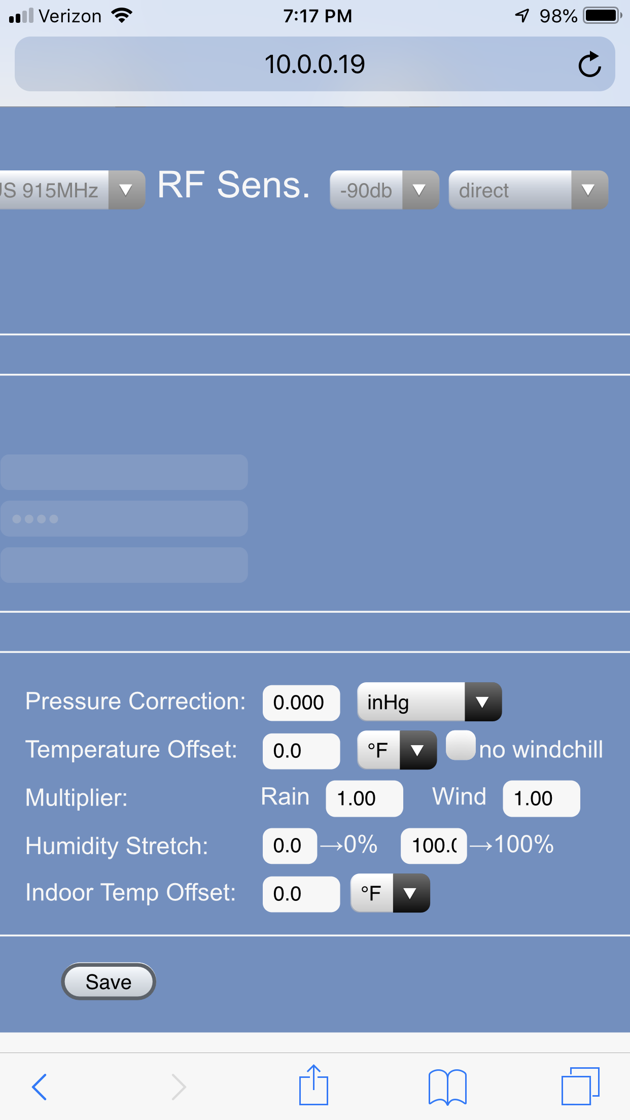

Did you switch off wind chill on "station" tab by accident?

Post by asull85 »
I’ve tried with it on and and off, no luck.
