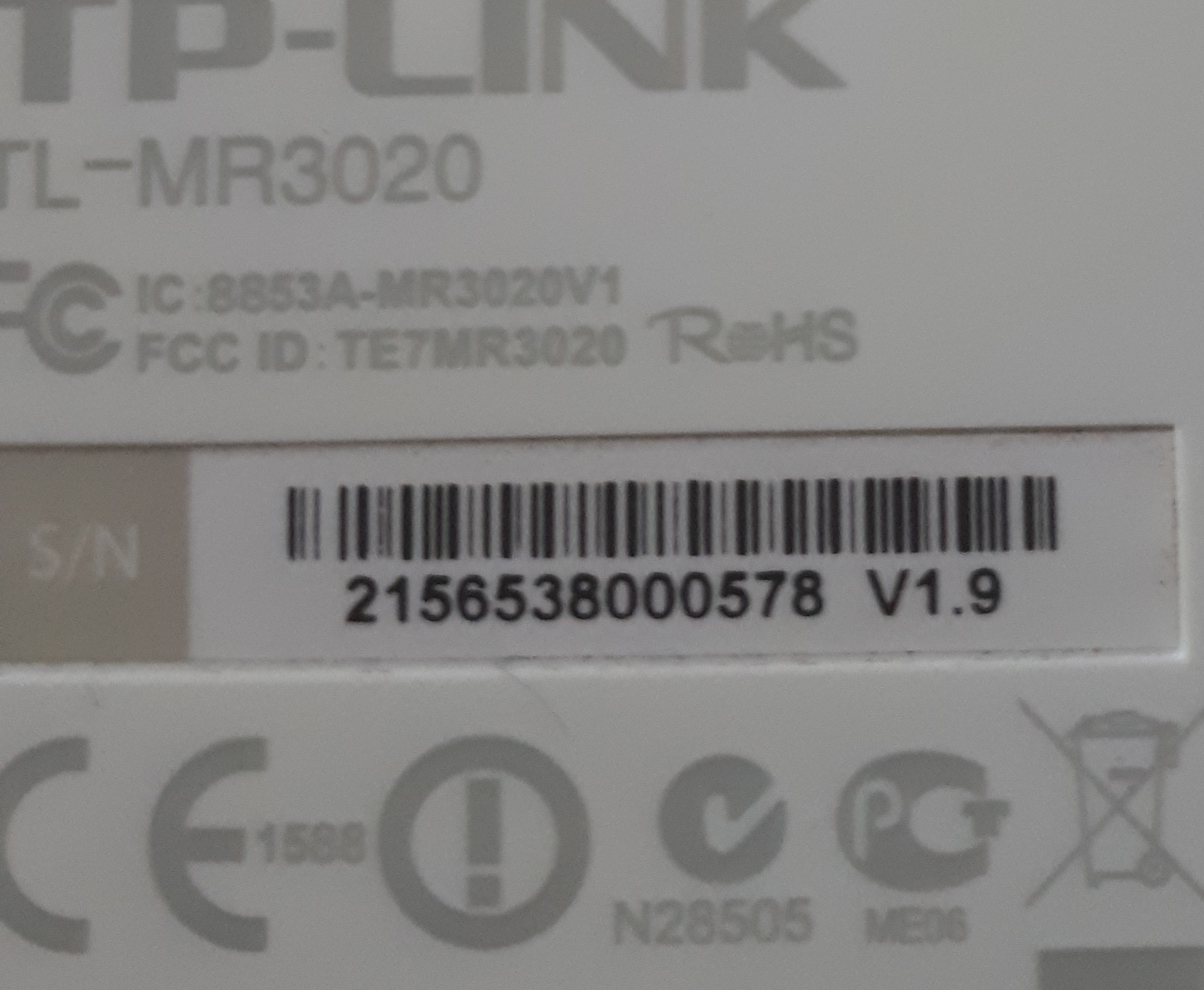

WARNING: incompatible MR3020 V1.9 routers out there! **solved**
Re: WARNING: incompatible MR3020 routers out there! RISK OF BRICK **solved**

Since I registered my new TL-WR902AC instead of this TL-MR3020(UN)1.9 it no longer is usable on MB. I attempted to flash it back to use as a repeater or a bridge but it will not flash to anything other than a "openwrt-15.05.1-ar71xx-generic-tl-mr3020-v1-squashfs-factory.bin" which is nothing more than Luci and mostly unusable as a router. Does anyone have a copy of the original as TP-LINK no longer lists the firmware for this device. I attemped to flash it to any version but just won't accept any firmware. I tried searching but could find no way to flash it back. Any help would be appreciated.
