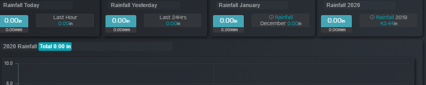

I have a error on Raintotal Alamanach?
We haven't had rain in 2020, but in December 2019.
Rain Error.jpg (16.21 KiB) Viewed 5652 times
checking across some sites but most have had some rainfall last 24 hours only two I could find that had not had any rain was showing no anomaly so I don't know the answer and my home PC is shutdown so I can't look at any files remotely .

It also looks like we are dealing with two different versions of the Template. The Rain Almanac Module on my template (latest version), Ron's and Toto's is showing Rain - # of days ago. The other's are showing December rain. Also, in my case the rainalmanac.php is showing rain in December as 0.00.

there has been no change to either almanac rain or main month year rain modules scripts the template will only display what is generated from meteobridge in the api. the template does not control what is sent to it .so i am at a loss of what can be done from template side apart from removing the feature. basically the december value of 0.0 is what is in the api data so upto January 1st this was not visible so im leaning towards an anomaly related to change of year and how last months december 2019 data is interpreted in the api. if anyone has any ideas im all ears . so possible thought is does the string [rain0total-max@M1] only work in current year ?
to add to the confusion here is Singapore weather showing last months rainfall total ..orange dot area ..
the string used is [rain0total-max@M1] based on the template variables listed in the wiki
@Mn addresses monthly data n months in the past.
Example: "[wind0wind-max@M0] will return max wind speed of current month, while "[wind0wind-max@M1]" will return max wind speed of previous month.
Singapore Home Weather Station.png (218.79 KiB) Viewed 5602 times

another this time uk in bold red for last month so I have no idea how to approach this apart from remove feature or take some mescaline and come back when its all over :-)

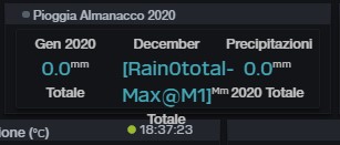

hi brian,i've this issue...what could be caused ?? and how to solve ??? thank you
I only noticed now that other users also have the same problem ...

weatherist34 wrote: Thu Jan 02, 2020 7:15 pm to add to the confusion here is Singapore weather showing last months rainfall total ..orange dot area ..

Yes, I see what you mean. Strange. My firmware is a little behind, but I don't see anything in the newer releases that would change the API. I do see that Boris has just released a new one.
chuck I don't see anything in recent firmware releases related to that string in the API has been there almost a year so im really guessing its a change of year thingy but why some have it and some don't is the mystery and I really have no idea .
weatherist34 wrote: Thu Jan 02, 2020 8:01 pm chuck I don't see anything in recent firmware releases related to that string in the API has been there almost a year so im really guessing its a change of year thingy but why some have it and some don't is the mystery and I really have no idea .
Yes, That’s what it looks like. Singapore is 13 hours ahead of me, so perhaps we will see a change later on. Maybe Boris will spot it, as well.
