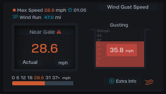

good morning Richard see above post 26th Jan update fixes that ..atlantic21 wrote: Tue Jan 26, 2021 10:24 pm Brian with the latest update the max wind is now not showing any value for me
before update
after
https://www.ilfracombeweather.net/console/index.php
have used the backup before update 20:55 to restore
Regards atlantic21

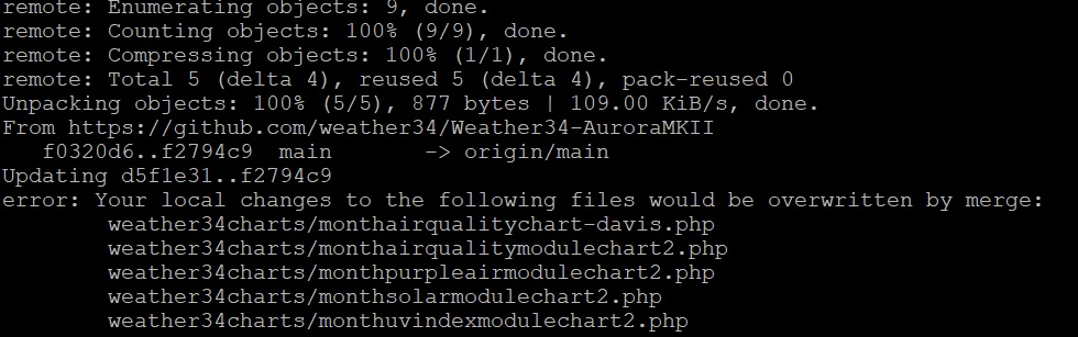

Hi
I'm updating via Git with:
sudo git pull
Now I get some errors. Any ideas what why?
Gert
sudo git pull
Gert

nope this is a GIT issue please refer this to the GITHUB communitygand wrote: Wed Jan 27, 2021 7:57 pm Hi
sudo git pull
Gert

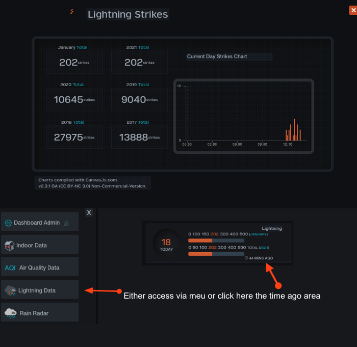

@Chuck please find in the GITHUB release a new file for lightning . mb-lightning.php which resides in the mb folder.
this will prepare for a new almanac screen and collection of chart data . see below . please let me know when you have this one file installed and setup .
in your TPLINK/DIR meteobridge hub goto services and add a new service you can run it every 30 seconds or 60 seconds what ever you wish .
at present it won't effect your current lightning display module , I just need you to run this new service so I ensure the output is as expected .
in the service url basically its a short collection of data (only lightning)
in meteobridge services upload every 1 minute(60 seconds)
the url
click save . it should start producing a file with lightning data called weather34-lightning.txt in the mb folder.
it will basically give you a pop up screen , this will also allow to build month year charts but one step at a time .
the chart takes the total strikes for every last 10 minutes so you dont miss anything .
for weatherflow Air module only does not work with other brands of lightning sensors. the string used [lgt0total-sum10.0:--]
the url
https://yourdomain.com/yourfolder/mb-lightning.php?d=[lgt0energy-act:--] [lgt0dist-act:--] [lgt0dist-age:--] [lgt0total-daysum.0:--] [lgt0total-monthsum.0:--] [lgt0total-yearsum.0:--] [lgt0total-sum10.0:--]it will basically give you a pop up screen , this will also allow to build month year charts but one step at a time .

Thanks for the info. I setup the https Service (60 sec.) in the TP that is presently sending the WF lightning data. I tried using the full URL code that you listed, but it did not produce the weather34-lightning.txt file. I then tried the abbreviated https://yourdomain.com/yourfolder/mb-lightning.php and it did generate the file (with minimal data).
Hope all is well.
https://myrtleweather.com/console/mbridge/weather34-lightning.txtChuck

thats perfect it tells me
-- -- 78934 0 13 13 --
0 energy (as there is none last 3 hrs)
0 distance (as there is none last 3 hrs)
78934 seconds ago (aprox 21 hours ago)
0 today
13 January
13 2021
0 last ten minutes

will build it around will update GITHUB sometime this evening
