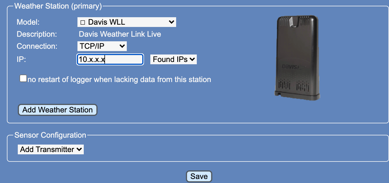

It would be helpfull if you posted a screenshot of the Meteobridge tab were you setup the WLL as your primary station.

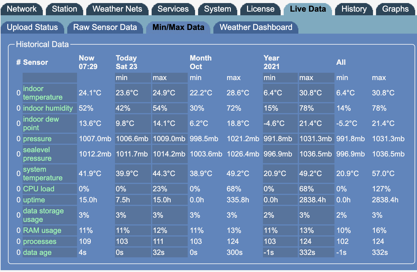

Screen Shot 2021-10-23 at 7.30.08 AM.png (293.4 KiB) Viewed 2268 times
Here's what I'm referring to when I say there is outdoor sensor just indoors

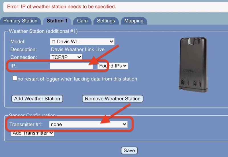

In that screenshot you did not specify which sensor sets you have.
Now only WLL integrated sensors are processed, that are inside temp/hum/pressure a.s.o.
Normally, transmitter nr 1 is the ISS (outside sensensuite). That ISS has all normal outside sensors temp, hum, wind a.s.o.
You have to add that in the second part, see attached screenshot.
You have to setup that before the Meteobridge knows were to look,
