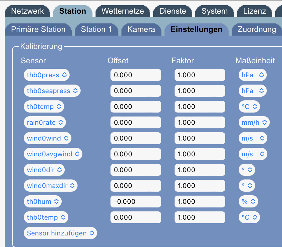

Thank You. I made this now but still shows the temperature in F (Imperial)

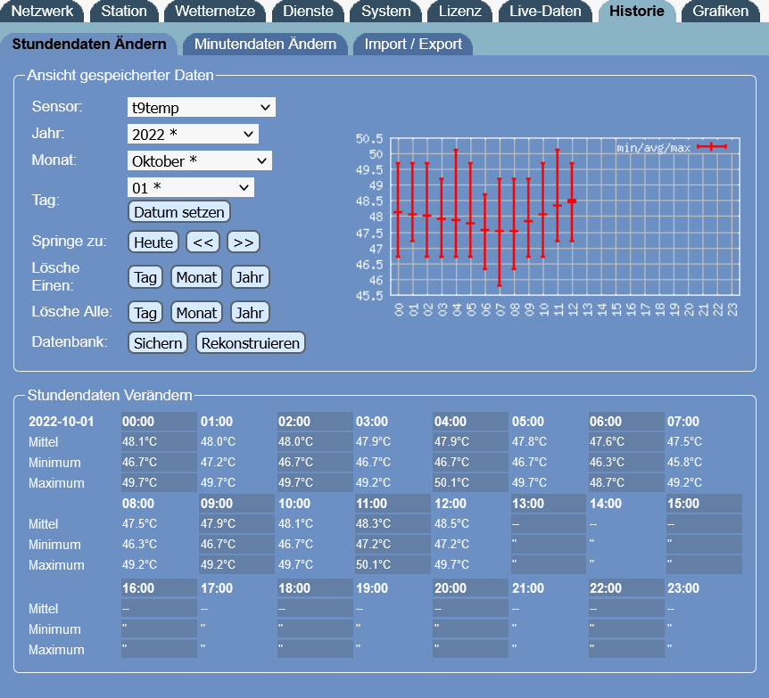

Although it shows ºC, the values ​​of over 40 degrees are probably not correct at all!
The exported data to weather networks are correct. Even when creating the graphics.
Why does it show values ​​over 40 in history?

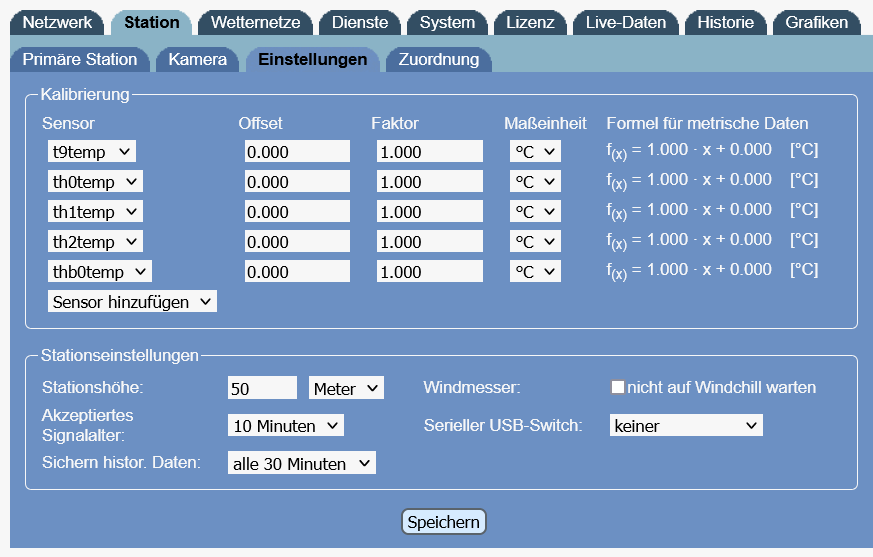

There is a switch on "system - administration" tab to change between Celsius and Fahrenheit.
Regarding t9temp, this is the Meteobridge system temperature (presumably an RPI) where 50°C looks pretty reasonable.
