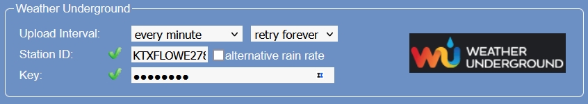

I have one final question & then I will let you be. On the Weather Networks tab under Weather Underground, there is a check box that reads alternative rain rate. Can you tell me what this is for & should I check the box?
Again, this issue is resolved & thank you for the help.

Normally, Meteoridge does a projection of current rain intensity into the future and this is reported as rain rate in mm/h. Some users heavily demanded to have a different view, that rain rate is the rainfall of last 60 minutes. If you want this logic applied, check the "alternative rain rate". I recommend not to select this.Laxet wrote: Sun May 26, 2024 3:57 pm I have one final question & then I will let you be. On the Weather Networks tab under Weather Underground, there is a check box that reads alternative rain rate. Can you tell me what this is for & should I check the box?
