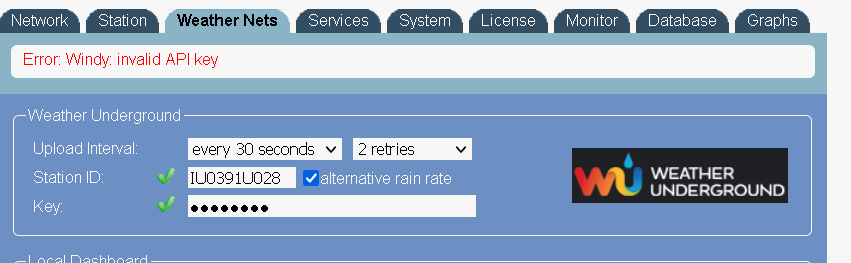

HI anyone
having problems with windy upload
Error: Windy: invalid API key
Thanks in advance

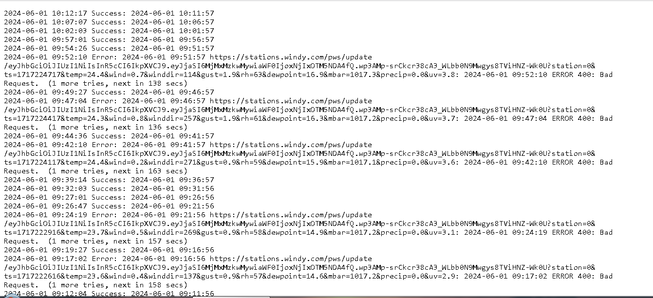

Re: Error: Windy: invalid API key
Thanks, I was able to login. Your uploads to Windy sometime work, sometimes Meteobridge receives a HTTP Error 400. Looks like network routing or timing issues to me:
2024-05-31 10:49:03 Success: 2024-05-31 10:48:53
2024-05-31 10:44:03 Success: 2024-05-31 10:43:53
2024-05-31 10:39:02 Success: 2024-05-31 10:38:53
2024-05-31 10:36:05 Error: 2024-05-31 10:33:52  https://stations.windy.com/pws/update/xxx?station=0&ts=1717148032&temp=14.7&wind=2.7&winddir=300&gust=4.3&rh=70&dewpoint=9.3&mbar=1019.6&precip=0.0&uv=3.6: 2024-05-31 10:36:05 ERROR 400: Bad Request.  (no more tries)
2024-05-31 10:29:02 Success: 2024-05-31 10:28:52
2024-05-31 10:24:04 Error: 2024-05-31 10:23:52  https://stations.windy.com/pws/update/xxx?station=0&ts=1717147432&temp=14.7&wind=2.9&winddir=302&gust=5.2&rh=70&dewpoint=9.3&mbar=1019.5&precip=0.0&uv=2.3: 2024-05-31 10:24:04 ERROR 400: Bad Request.  (no more tries)
2024-05-31 10:19:04 Success: 2024-05-31 10:18:52
2024-05-31 10:14:01 Success: 2024-05-31 10:13:52
2024-05-31 10:09:02 Error: 2024-05-31 10:08:52  https://stations.windy.com/pws/update/xxx?station=0&ts=1717146532&temp=14.5&wind=1.9&winddir=0&gust=4.7&rh=70&dewpoint=9.1&mbar=1019.5&precip=0.0&uv=2.2: 2024-05-31 10:09:02 ERROR 400: Bad Request.  (no more tries)
2024-05-31 10:04:01 Error: 2024-05-31 10:03:52  https://stations.windy.com/pws/update/xxx?station=0&ts=1717146232&temp=14.3&wind=1.8&winddir=331&gust=3.3&rh=71&dewpoint=9.1&mbar=1019.5&precip=0.0&uv=3.2: 2024-05-31 10:04:01 ERROR 400: Bad Request.  (no more tries)
2024-05-31 10:01:07 Success: 2024-05-31 09:58:52
2024-05-31 09:56:05 Error: 2024-05-31 09:53:51  https://stations.windy.com/pws/update/xxx?station=0&ts=1717145631&temp=14.2&wind=1.9&winddir=319&gust=4.3&rh=71&dewpoint=9.0&mbar=1019.4&precip=0.0&uv=2.7: 2024-05-31 09:56:05 ERROR 400: Bad Request.  (no more tries)
2024-05-31 09:51:06 Success: 2024-05-31 09:48:51
I did a bit more research, windy has a minimum sent interval of 5 minutes. As you sent every 5 minutes, this might conflict here and there.
"update":{"update":{"stations":[],"observations":[{"si":0,"time":"2024-05-31T10:23:15.000Z","temp":12.2,"wind":1.5,"wind_dir":312,"wind_gust":4.7,"rh":80,"dew_point":8.9,"pressure":101670,"precip":0,"uv":0}]},"errors":{"observations":[],"stations":[]}},"result":{"0":{"stations":[],"observations":[{"success":false,"value":{"si":0,"time":"2024-05-31T10:23:15.000Z","temp":12.2,"wind":1.5,"wind_dir":312,"wind_gust":4.7,"rh":80,"dew_point":8.9,"pressure":101670,"precip":0,"uv":0},"error":"Measurement sent too soon, update interval is 5 minutes"}]}}}
When you set send interval to 10 min in Meteobridge, all will be fine. As an alternative, you can ask Windy to make it a bit more tolerant on there side.
This error even occurs on your system when update interval set to 10 mins. Only explanation I have is that you have another PC reporting with same credentials to windy and this causes the rejections.

Post by Platokidd »
admin wrote: Fri May 31, 2024 11:15 pm This error even occurs on your system when update interval set to 10 mins. Only explanation I have is that you have another PC reporting with same credentials to windy and this causes the rejections.
The meteobridge is the only source that I send data to Windy. Been sending data to Windy for a few years without issue. Just noticed this recently. I know CWOP sends my data to Windy.
Your Meteobridge is uploading partly fine to Windy. I have given you my analysis. Windy is rejecting packets with "you send too often" message. Please contact windy to get it fixed on their side.
