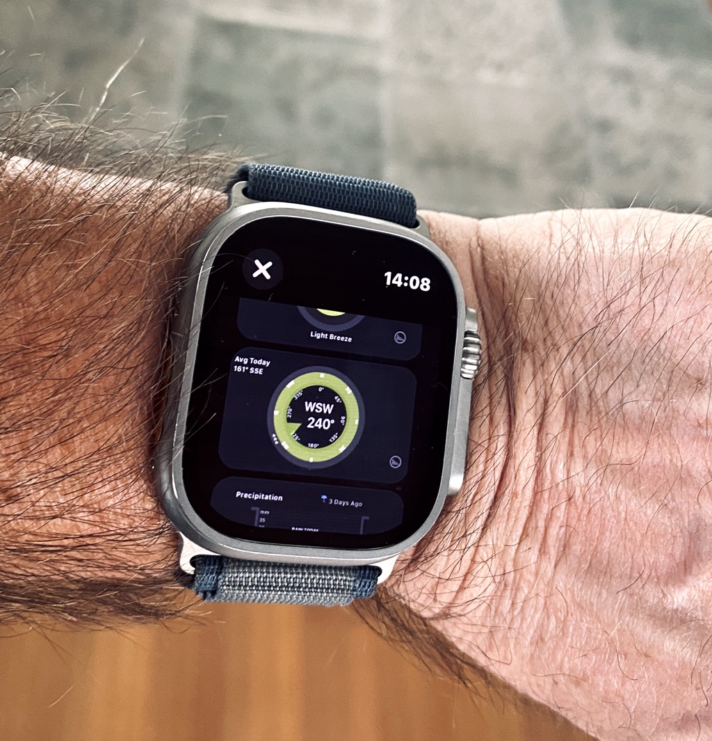

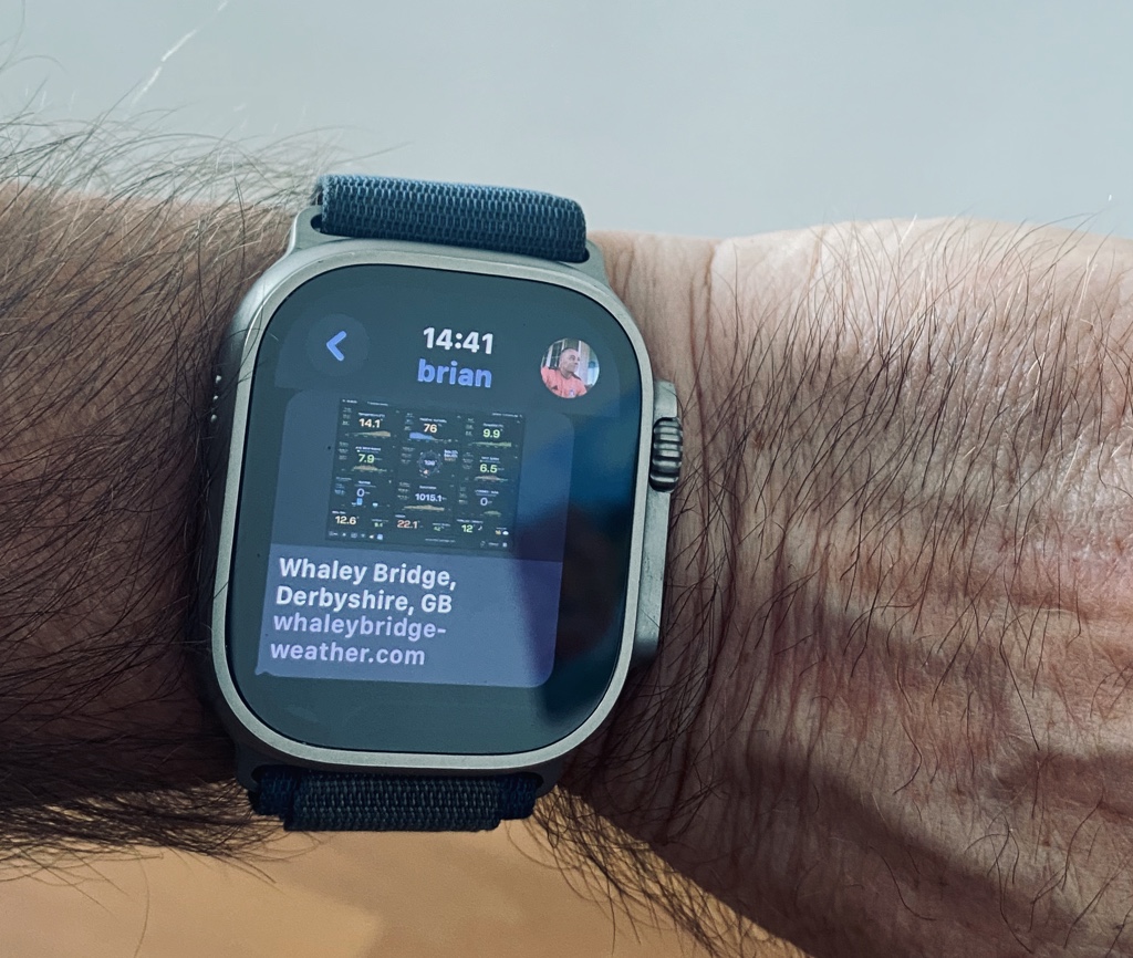

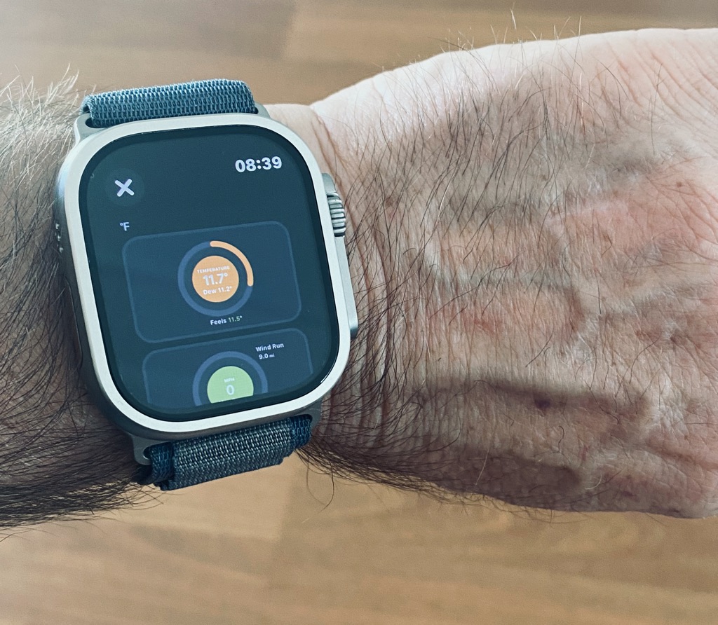

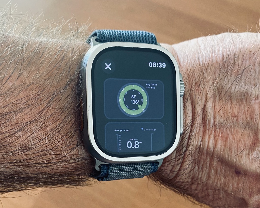

hello sorry it has been a while just summer is still lingering on so outside a lot cycling most days.
so I have a minor update that really doesnt change much to anything visually or additional data etc it is just minor update for apple watch users specifically Ultra/2 users .based on request to increase the size of the modules.

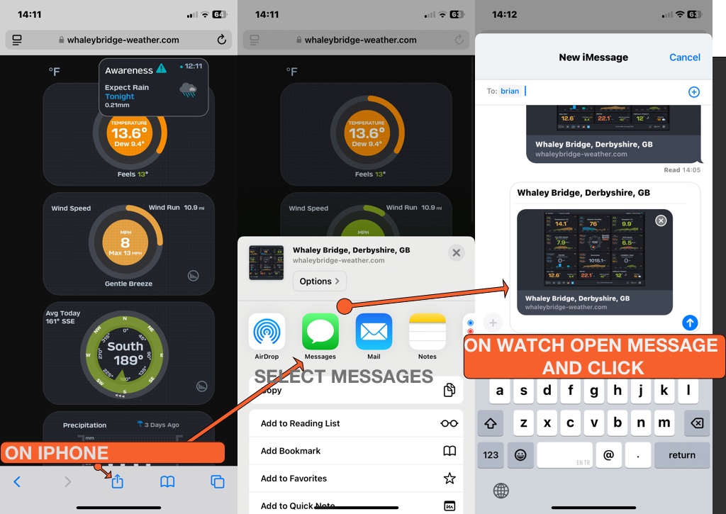

a tip ! you no longer require a 3rd party browser to view on website using a simplified method just view your website on your iPhone or desktop PC and share it to yourself via a text message OR email and simply click on watch click url in message received and voila. see below and it doesn't matter wether it is ultra original 1 or 2 both are identical in screen size (ULTRA2 is shown but there is no difference in screen).simply use the crown or your fingers to swipe(scroll) up and down if using ULTRA2 you can simply double tap your fingers using the double tap gesture to scroll up and down.

1. use safari on iphone goto your website url and then select the apple watch icon at the bottom
2.now select share icon
3.choose messages
4.send a message to yourself
5 open messages on apple watch and open the url ..
sounds complex but its not because the url is always stored in messages until you delete so always can open on watch if required via messages.

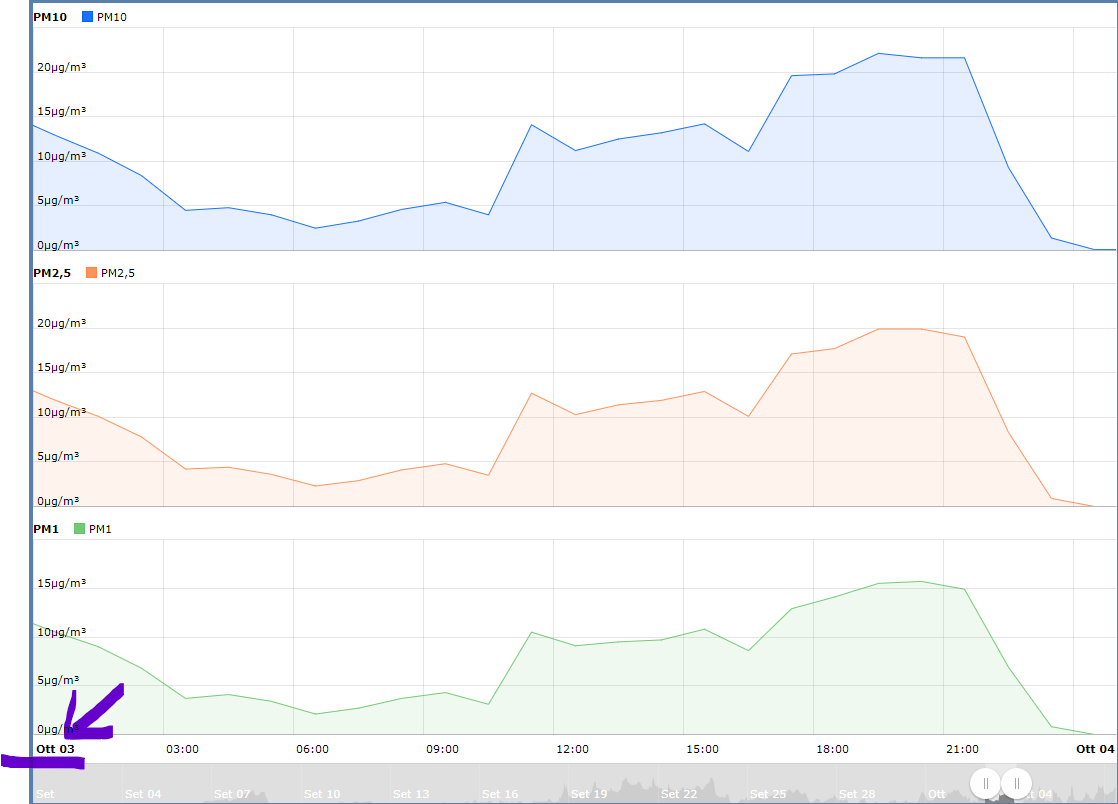

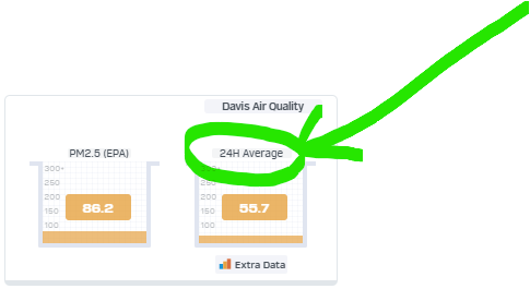

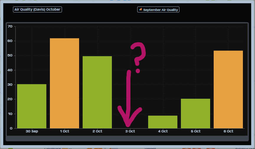

Hi. I just installed the Davis AirLink. I think there is a problem with the data displayed. The "24 hour average" is actually the average for the current day and the data displayed in the monthly and yearly charts is not the average for the day.

good morninglorenz1982 wrote: Mon Oct 07, 2024 9:19 am Hi. I just installed the Davis AirLink. I think there is a problem with the data displayed. The "24 hour average" is actually the average for the current day and the data displayed in the monthly and yearly charts is not the average for the day.
i will take a look tonight but can I ask one question ? does this happen every end of day run or is it random ? looking at your chart it shows there are days when it runs or produces data ok . the data comes from an api call if it is random then something beyond template is causing the missing data.

It's like @ToTo says (viewtopic.php?p=39222#p39222).
The 24H AVG value is not the average of the previous 24 hours but is actually the daily average.
The call weather34-chart-end-of-day.php is at 2:00 and the chart shows a value that is the average of the current day from midnight to 2 and not of the previous day.
This happens every day.

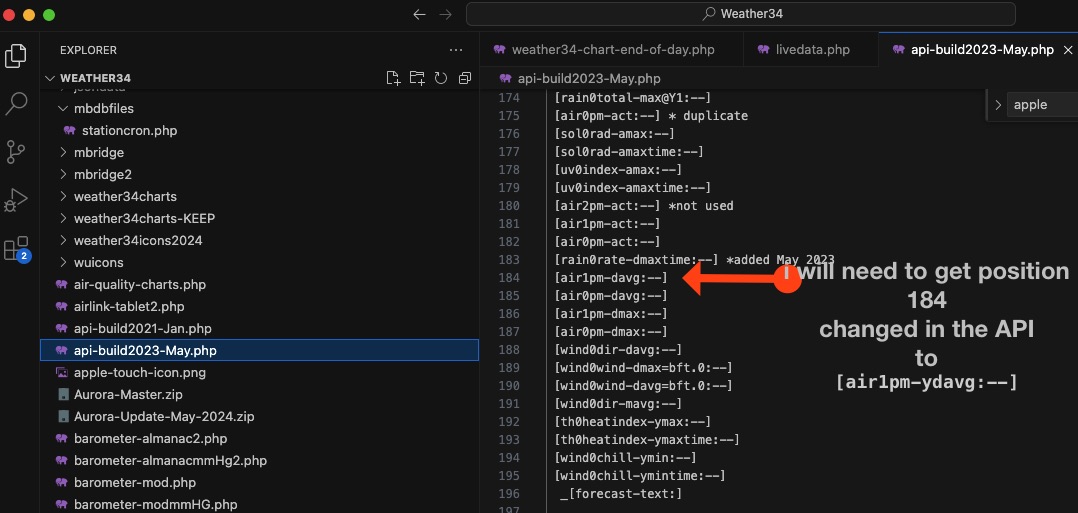

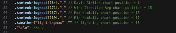

after taking a look i can ask Boris to change the API position 184 from [air1pm-davg:--] to [air1pm-ydavg:--] its currently as you mentioned reading current day average that said i need to cross check the position 184 [air1pm-davg:--] is being used elsewhere i have a sneaking feeling it is
i will get in touch with boris once ive recompiled the API not something I enjoy doing because it can go wrong with a simple typo mistake
be in touch ..

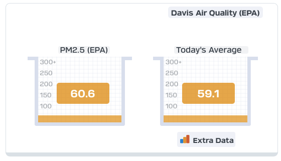

Hi. The old description remained in the first dashboard.
- Immagine 2024-10-21 090802.png (16.78 KiB) Viewed 10665 times

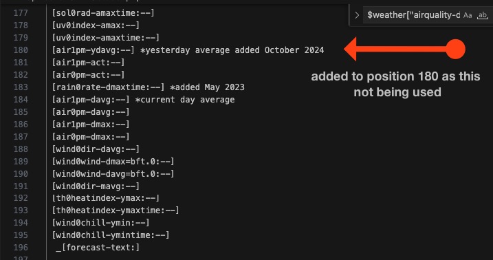

- Posts: 1824
Re: Weather34 Downloads

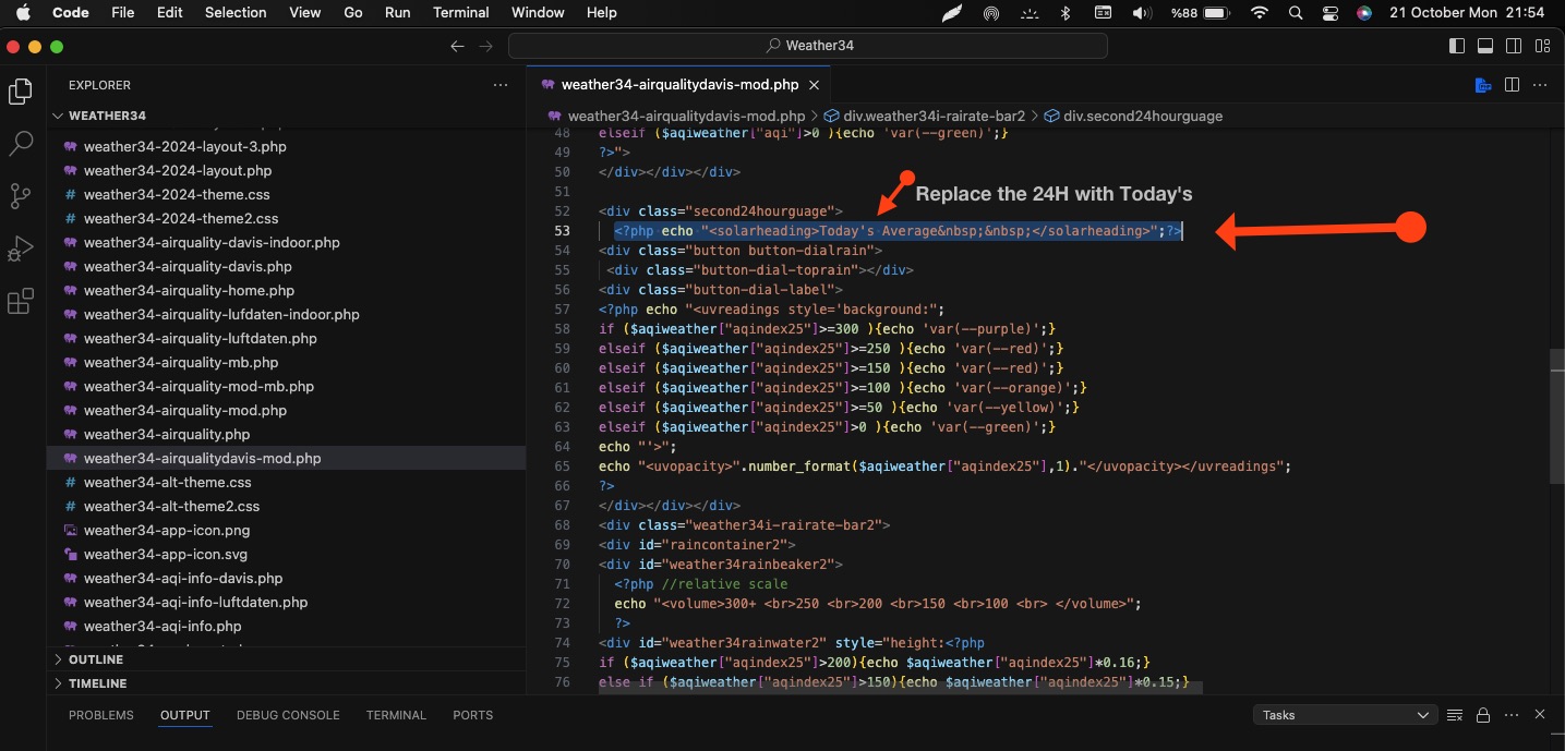

good evening , thank you updated perhaps next month push another update , wait and see if anything else needs doing.
if you need to change quickly find the file weather34-airqualitydavis-mod.php
see the screenshot below and change the line highlighted ..
..brian
