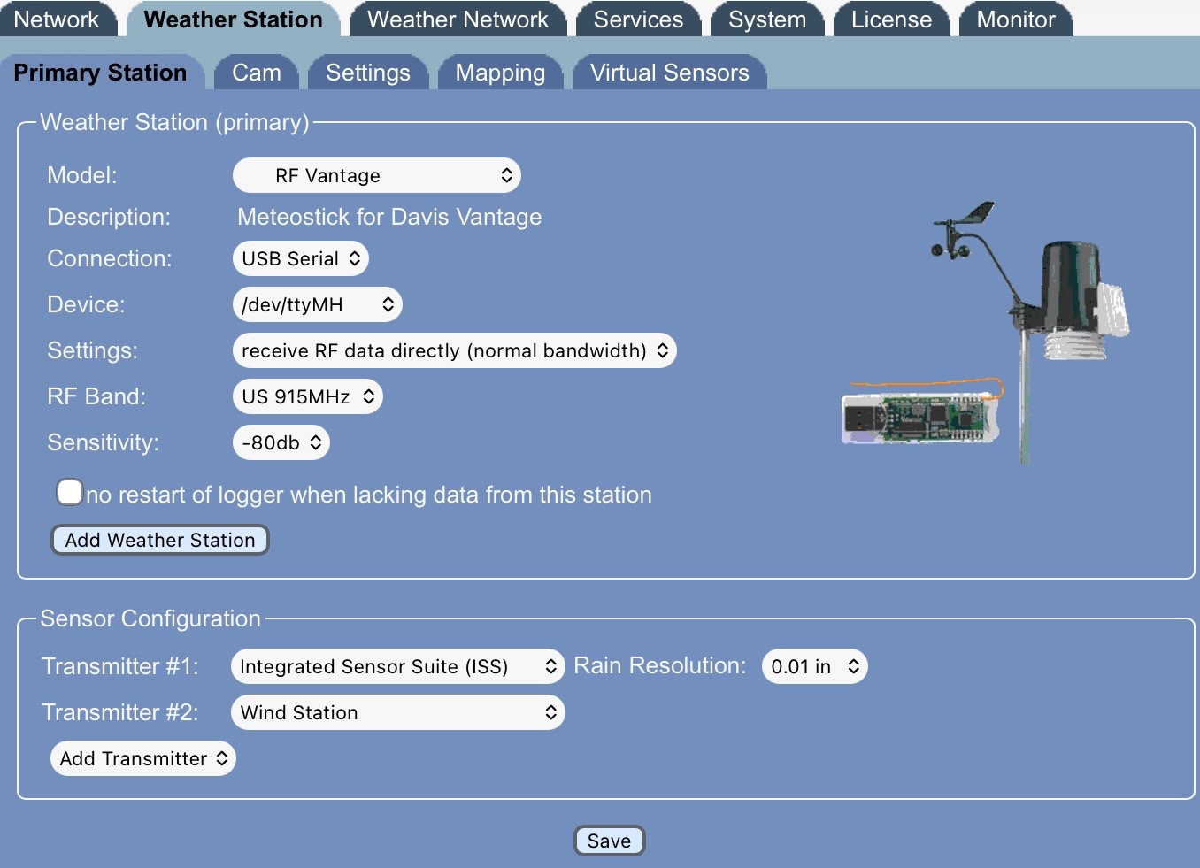

Which software is processing the Meteostick data in your setup, Meteohub, Meteobridge or something else? Where are you seeing the false solar readings: in that software's live data or in data uploaded to a weather service?

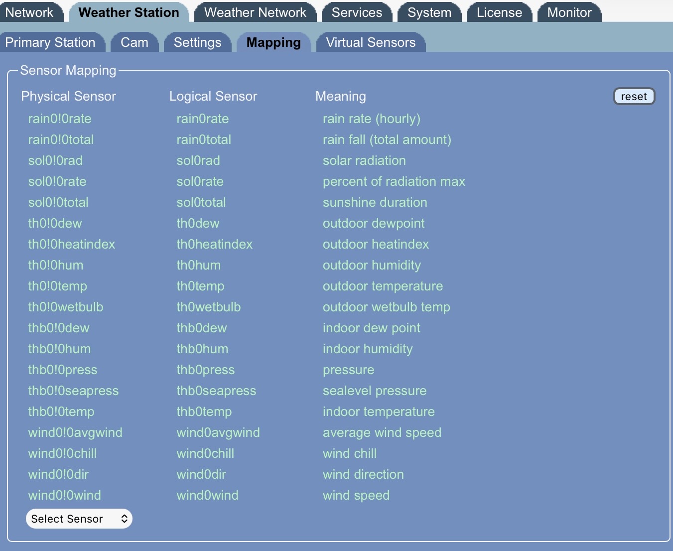

From the screen dumps I just see that there is a default mapping for a potential solar radiation sensor. These mapping rules are not adapted to the sensors you currently have.
Does "Monitoring - Live Data" show any solar data? If not, you simply misunderstood the mapping tab.
