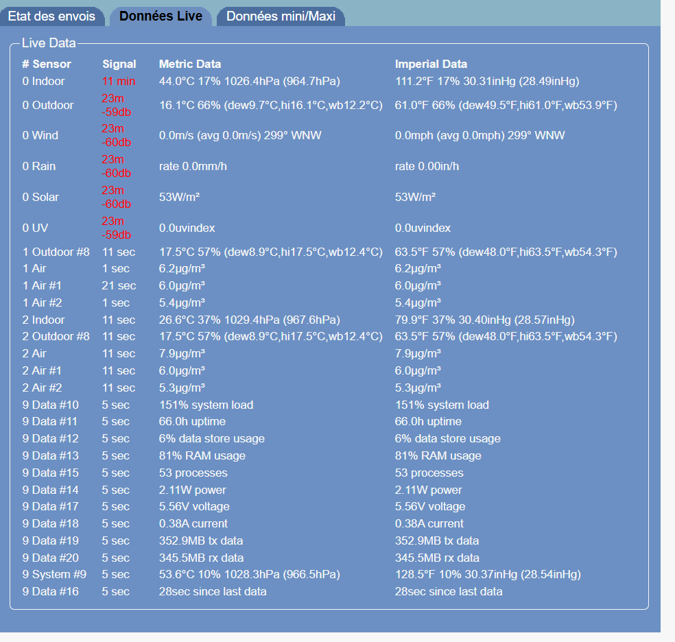

I am experiencing recurring Davis RF reception failures with my Meteobridge PRO Red.
My setup:
- Meteobridge PRO Red, software version 6.4 (build 15721).
- Meteostick RF firmware version 3.4.
- Davis Vantage Pro2 Plus, using a Davis RF repeater.
- Station 0: Davis RF Vantage.
- Station 1: AirLink.
- Station 2: WeatherLink Cloud.
The Davis console continues receiving outdoor sensor data normally, while Meteobridge station 0 suddenly stops receiving valid RF data.
During these incidents, stations 1 and 2 continue working normally. Meteobridge itself remains operational, including data uploads.

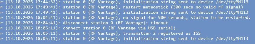

The log shows:
station 0 (RF Vantage), restart meteostick (300 secs no valid rf signal)
station 0 (RF Vantage), no signal for 900 seconds, station to be restarted.
disconnect station 0 (RF Vantage): timeout
connect station 0 (RF Vantage) via USB serial.
Automatic Meteostick restarts do not appear to restore reception.
On October 13, the outage lasted more than 30 minutes. I reloaded RF firmware 3.4 without rebooting the entire Meteobridge PRO. Reception initially returned partially, then all Davis outdoor sensors started reporting again.
The Meteobridge uptime remained unchanged.

Looking at your documented signal strength I recommend a RF threshold of -70db.
