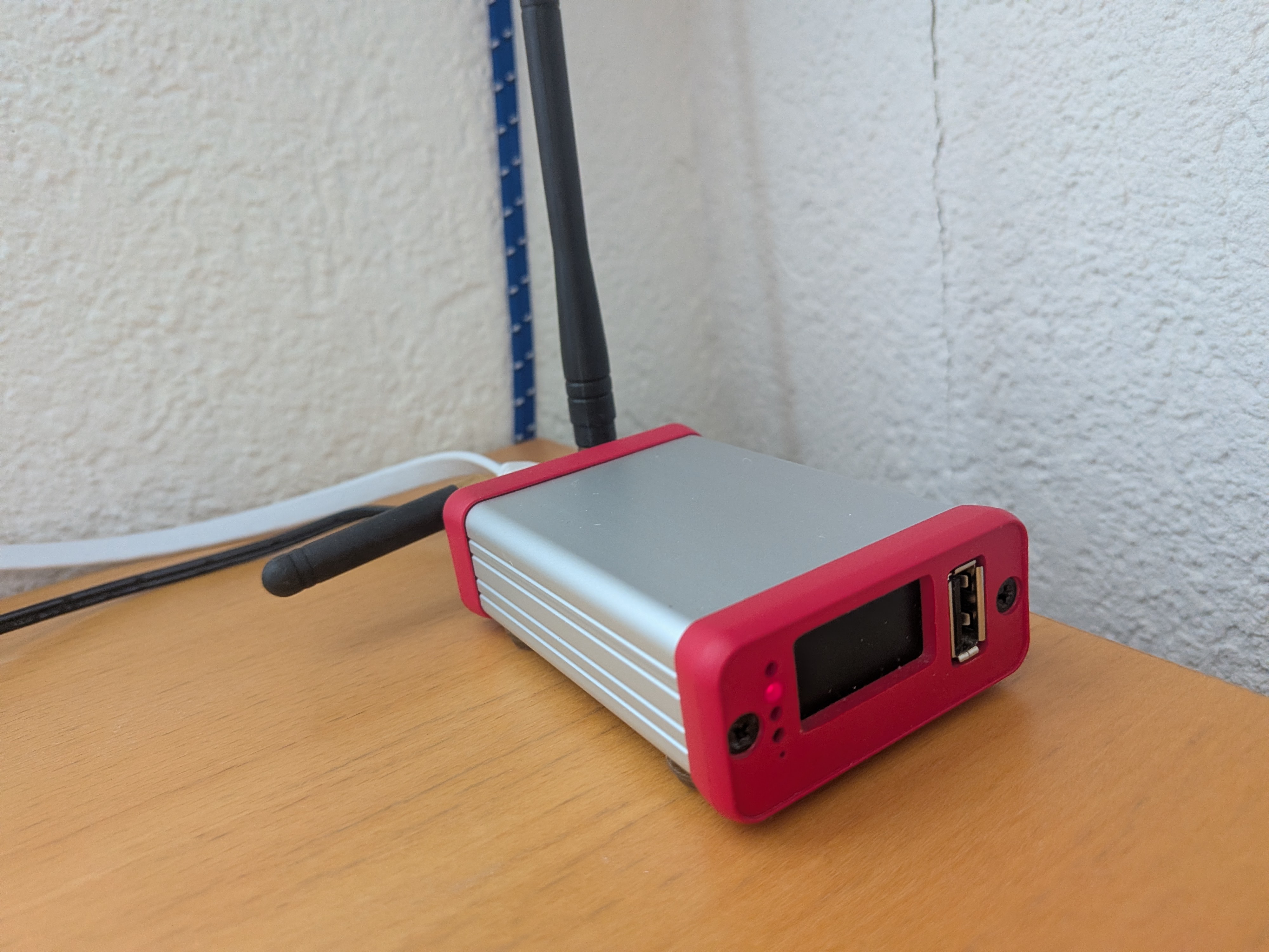

After several tests and some research, I may have found a specific configuration that could resolve the issue. So far, it has been running uninterrupted for 185 hours without any problems.
Adjusting the setting to -70 dB was not enough on its own to stop the freezing/lock-ups.
However, I repositioned my Wi-Fi antenna horizontally, as shown in the photo; since then, the freezing has not recurred—even though I don’t actually use Wi-Fi for communication (I have an Ethernet connection).
It seems there must be some interference between the two antennas, likely because they are positioned quite close to each other.
In any case, the RF signal has improved significantly, and—most importantly—there have been no further lock-ups. I will keep you posted if the issue happens again.
