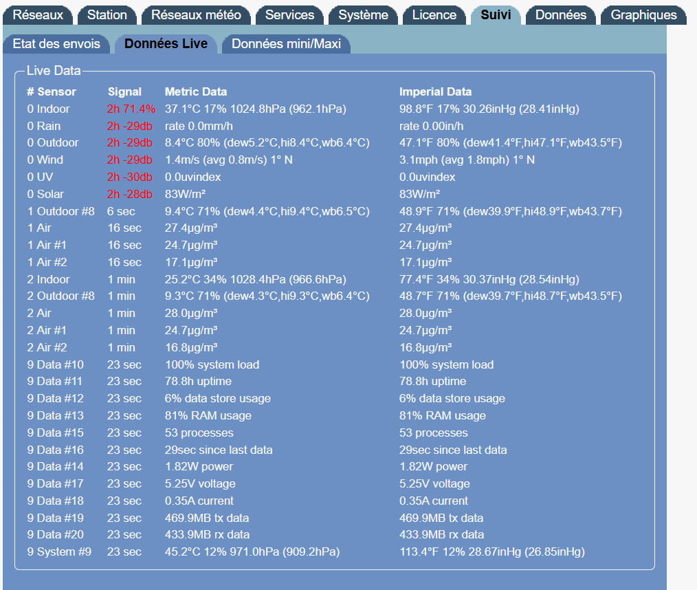

I am experiencing recurring Davis RF reception failures with my Meteobridge PRO Red.
My setup:
- Meteobridge PRO Red, software version 6.4 (build 15721).
- Meteostick RF firmware version 3.4.
- Davis Vantage Pro2 Plus, using a Davis RF repeater.
- Station 0: Davis RF Vantage.
- Station 1: AirLink.
- Station 2: WeatherLink Cloud.
The Davis console continues receiving outdoor sensor data normally, while Meteobridge station 0 suddenly stops receiving valid RF data.
During these incidents, stations 1 and 2 continue working normally. Meteobridge itself remains operational, including data uploads.
The log shows:
station 0 (RF Vantage), restart meteostick (300 secs no valid rf signal)
station 0 (RF Vantage), no signal for 900 seconds, station to be restarted.
disconnect station 0 (RF Vantage): timeout
connect station 0 (RF Vantage) via USB serial.
Automatic Meteostick restarts do not appear to restore reception.
On October 13, the outage lasted more than 30 minutes. I reloaded RF firmware 3.4 without rebooting the entire Meteobridge PRO. Reception initially returned partially, then all Davis outdoor sensors started reporting again.
The Meteobridge uptime remained unchanged.
I have a few questions:
1. Is this a known issue with Meteobridge PRO Red or Meteostick firmware 3.4?
2. Could it be related to the software or RF firmware updates?
3. Is there a way to restart or fully reset the RF receiver without reflashing its firmware or rebooting the entire Meteobridge?
4. Would you recommend checking the RF threshold, interference, USB communication, or another setting?
Any suggestions would be greatly appreciated.
Thank you for your help.

Looking at your documented signal strength I recommend a RF threshold of -70db.

After several tests and some research, I may have found a specific configuration that could resolve the issue. So far, it has been running uninterrupted for 185 hours without any problems.
Adjusting the setting to -70 dB was not enough on its own to stop the freezing/lock-ups.
However, I repositioned my Wi-Fi antenna horizontally, as shown in the photo; since then, the freezing has not recurred—even though I don’t actually use Wi-Fi for communication (I have an Ethernet connection).
It seems there must be some interference between the two antennas, likely because they are positioned quite close to each other.
In any case, the RF signal has improved significantly, and—most importantly—there have been no further lock-ups. I will keep you posted if the issue happens again.

I am returning to this post regarding my issue.
It turned out that the antenna's mini-coaxial cable was broken, so I had a specialist resolder it. The RF signal is now very strong.
I thought I had permanently resolved the issue, but unfortunately, the very next day, my Meteobridge stopped working (specifically the RF module component).
Adjusting the position of the Wi-Fi antenna was, therefore, not the right solution to the problem.
I restarted my Meteobridge, but about 24 hours later, it stopped receiving signals from the RF module again.
I am going to replace the power supply, hoping that is the source of the trouble. However, I find it strange that only the RF module would be affected if the power supply were the culprit!

Despite all my attempts—even after changing the power supply—I am experiencing an RF failure again, after just over two days.
I don’t know what else to do. Could the administrator provide an explanation?

logger (30.10.2026 15:55:32): station 0 (RF Vantage), no synchronization for 900 seconds, data logger will be restarted.
logger (30.10.2026 15:55:32): disconnect station 0 (RF Vantage): timeout
logger (30.10.2026 15:56:02): connect station 0 (RF Vantage via USB serial).
logger (30.10.2026 16:10:33): station 0 (RF Vantage), no synchronization for 900 seconds, data logger will be restarted.
logger (30.10.2026 16:10:33): disconnect station 0 (RF Vantage): timeout
logger (30.10.2026 16:11:03): connect station 0 (RF Vantage via USB serial).
logger (30.10.2026 16:25:34): station 0 (RF Vantage), no synchronization for 900 seconds, data logger will be restarted.
logger (30.10.2026 16:25:34): disconnect station 0 (RF Vantage): timeout
logger (30.10.2026 16:26:04): connect station 0 (RF Vantage via USB serial).
logger (30.10.2026 16:40:35): station 0 (RF Vantage), no synchronization for 900 seconds, data logger will be restarted.
logger (30.10.2026 16:40:35): disconnect station 0 (RF Vantage): timeout
logger (30.10.2026 16:41:05): connect station 0 (RF Vantage via USB serial).
logger (30.10.2026 16:55:36): station 0 (RF Vantage), no synchronization for 900 seconds, data logger will be restarted.
logger (30.10.2026 16:55:36): disconnect station 0 (RF Vantage): timeout
logger (30.10.2026 16:56:06): connect station 0 (RF Vantage via USB serial).
- panne_recurrante.png (122.47 KiB) Viewed 45 times
