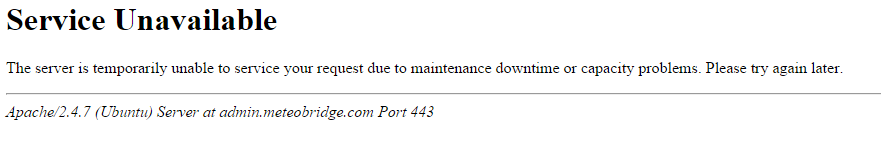

After I change to newest built and restart, the error message is:
Re: Cannot Connect to Meteobridge Remote Access
Just released an update for Meteobridges that makes use of yesterdays server side adaptions. Please reboot your Meteobridge again to have that applied and I hope that this solves most of the issues.
