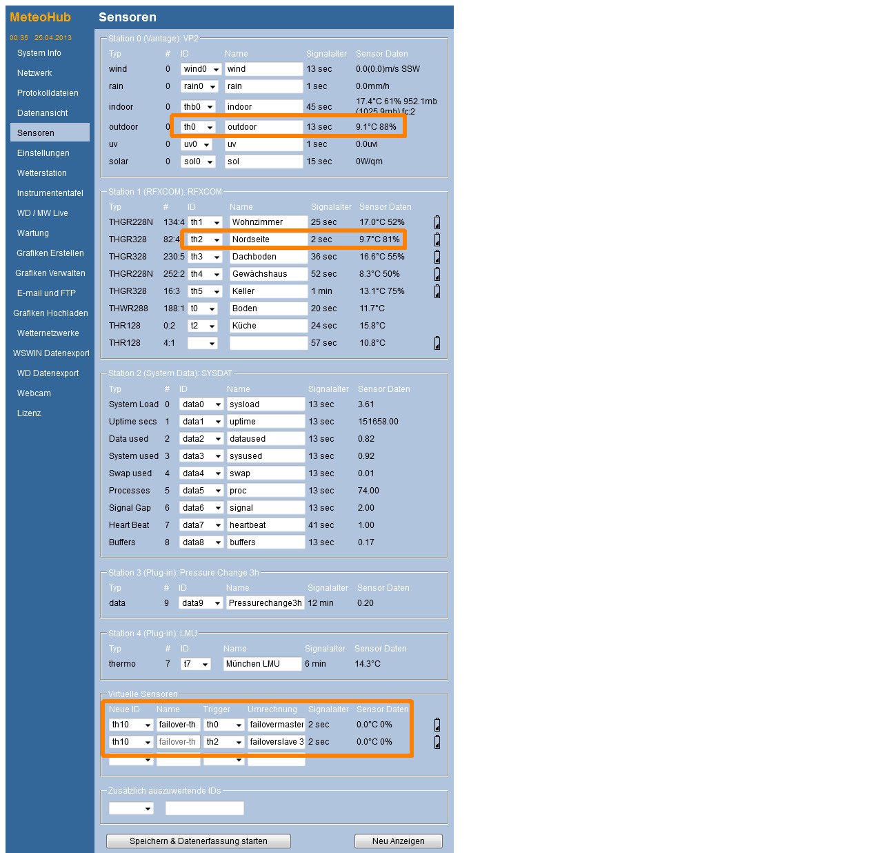

since 4.9u there´s something wrong with the virtual sensor failovermaster-slave function.
it always showing 0.0°C as value and not the correct one of the master and slave sensors :roll:
