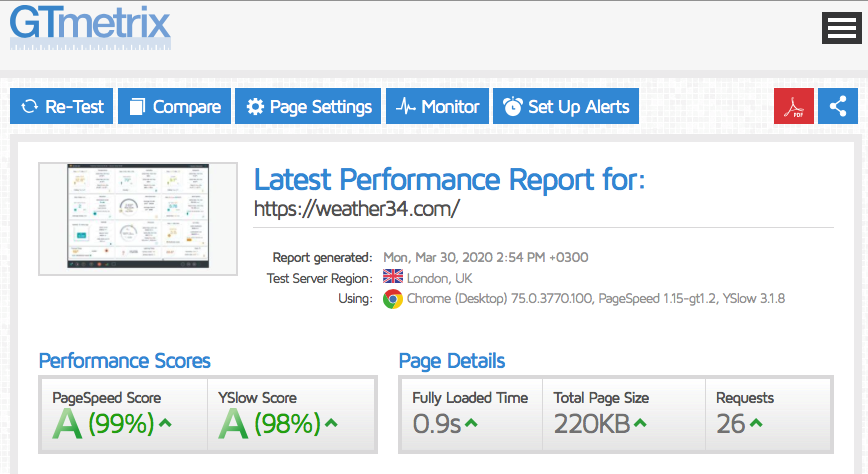

nice benefit of the Standalone version meteobridge NANO(SD),Pro,Tp link etc is now able to use the template and can't reiterate enough how much smaller the footprint is..
screenshot ...
GTMETRIX 30TH MARCH 2020 //
Screenshot at Mar 30 14-55-14.png (140.4 KiB) Viewed 6236 times
however results can vary as time of day(WWW load) or per hosting setups .ICDSOFT has the less talked about enhancement enabled brotli compression as most are still using the GZIP method .the differences are negligible but beneficial .

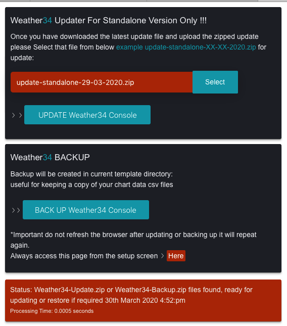

updates for the newer Standalone version https://weather34.com/homeweatherstatio ... alone.html
will come via a separate update file in due course using this screen(screenshot).
each update is structured to only update the Standalone version . example update-standalone-29-03-2020.zip
if you were to use that update on the NANOSD version it would not update the structure correctly and break it.
Cant reiterate enough the advice not to run both versions but the choice is yours I can only advise.
ive highlighted everywhere I possibly could about what the differences are but seems its not getting across
Screenshot at Mar 30 17-52-42.png (92.79 KiB) Viewed 6214 times
PLEASE DO NOT RUN BOTH VERSIONS SIMULTANEOUSLY I CANT HIGHLIGHT THIS ENOUGH...UNLESS YOU KNOW HOW TO SETUP MORE REQUESTS IN METEOBRIDGE
already 7 emails last hour and all related to running both versions simultanousely the issue is charts/forecast/air quality you can NOT run both simultaneously without creating extra 'get' request in the Services panel from meteobridge this will inadvertently create an extra load on meteobridge itself as well .
the two versions are completely different structure its like putting diesel into a petrol engine = fail..
im trying to help not complain ..

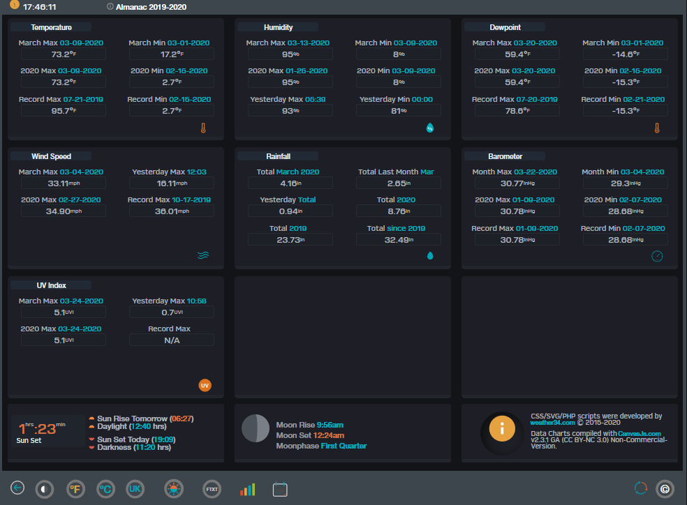

Here is what my Almanac looks like now.
Almanac Missing Solar & Time.PNG (103.56 KiB) Viewed 6160 times
Hi Ron,
I noticed the same issue after I applied the console update file (30-3-2020) earlier today. I rolled back the updated files and the 2 Panels came back.

sorry about the solar/clock almanac applied update to GITHUB or use small update file 48kb
http://www.mediafire.com/file/css9rkizv ... 0.zip/file
