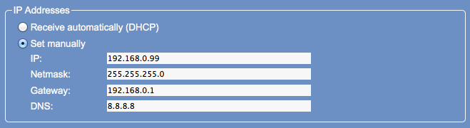

When I login I can check with pings, that DNS resolution is extremely slow. That means
your provider has a massive problem there. Fortunately, you can use google DNS at 8.8.8.8
I switched your IP setup to static, using google DNS and setting IP to 192.168.0.99
Screen Shot 2014-11-23 at 22.03.41.png (20.74 KiB) Viewed 3646 times
Now it works fine again...
