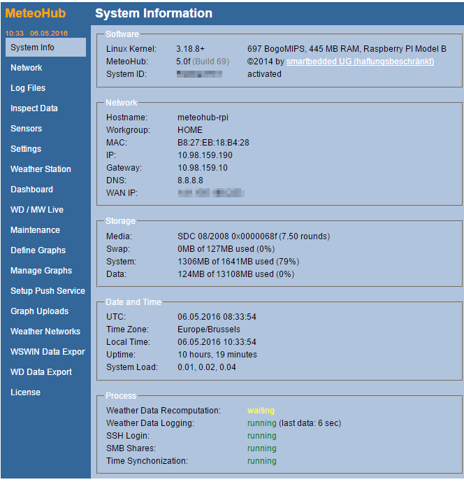

I'm using Rpi 1 with build 5.0f
My system worked well for several months, but due to a power failure, it's rebooted, after that, the recompuntation of weather data is stuck, it's still 'waiting', as you can see in the attachment.
Meteohub status
Meteohub status
It was like this for several days, then I tried to reboot again (from the GUI), but again, it's 'waiting' for more then 10 hrs now.
anything I can do, without loosing data?
Is the incoming data still logged, or is this all lost?
Erwin

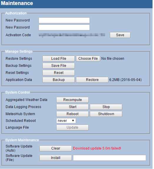

Update Failed
Update Failed
2016-05-06 11_33_11-Settings.png (32.57 KiB) Viewed 6498 times
Tried to do that, but it failed...
So i looked at some log files, and saw this :
May  6 11:15:46 meteohub-rpi exim[13692]: 2016-05-06 11:15:46 1aybrO-0003Yq-BO Failed to create spool file /var/spool/exim4/input//1aybrO-0003Yq-BO-D: No space left on device
This is strange, because I have some room left, even on the rootfs :

to bad the rootfs is that small, my data-part is 13Gb with almost no usage.
Anything I can do to fix that ?

Root file system is defective. I guess you need a new SD card and set it up again.
You find help in migrating to a new SD card here:
viewtopic.php?f=23&t=5415
