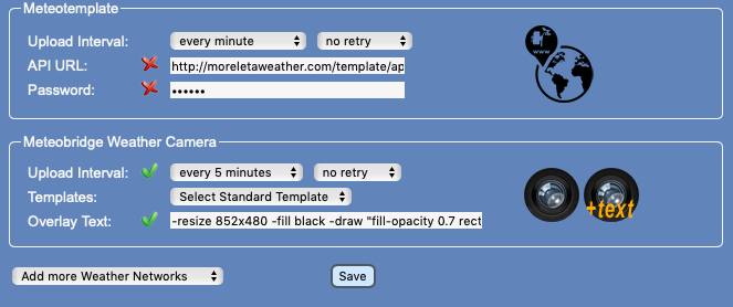

One of my devices (TP link MR 3020 version 1 ) suddenly stopped uploading to meteotemplate.
I have done a simple reboot without success.
I have also deleted the weather network upload and then re-enabled it without success.

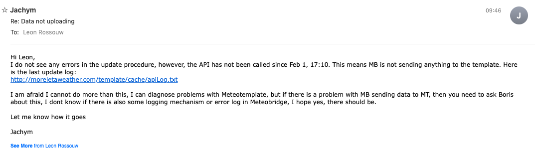

I have contacted Jachym from meteotemplate thinking the problem might be on server side there.
Please see his response in attached screenshot.
Any help please !

Are you getting a white error box at the top of the Weather Networks page by any chance?
I've found that passwords with special characters tend not to work with the Meteotemplate upload API.php - maybe3 try a new, simple password?
