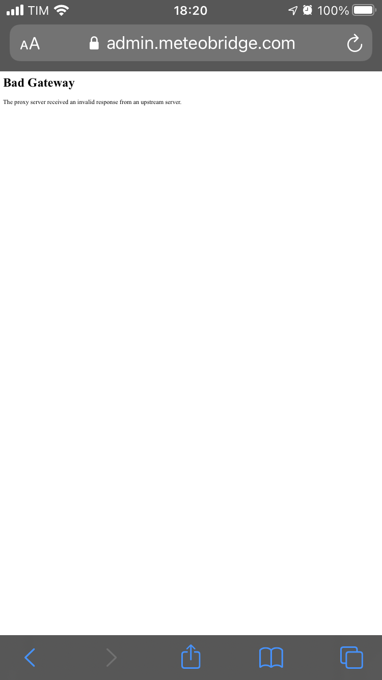

if I click on history this page comes out with this writing:
Bad Gateway
The proxy server received an invalid response from an upstream server.
and even if I click on the weather data to change them

I have a problem with the raspberry pi 4 the history does not work and I can not update min and max this message comes out:
Bad Gateway
Re: Rpi problem history
norvegese wrote: Mon Nov 30, 2020 2:23 pm I have a problem with the raspberry pi 4 the history does not work and I can not update min and max this message comes out:
Bad Gateway

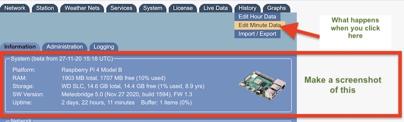

As asked before mak a screen-shot of the system tab
and
Make a screen-shot of what shows on the minute tab.
See an example I attached of my raspberry

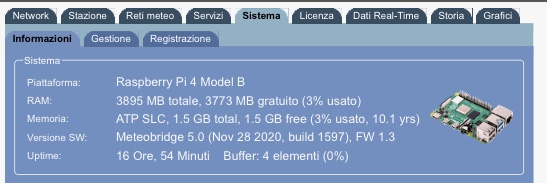

norvegese
Posts: 25
Joined: Wed Mar 04, 2020 9:08 am
Post by norvegese »
norvegese
Posts: 25
Post by norvegese »

norvegese wrote: Mon Nov 30, 2020 4:33 pm
Well I almost sure that you need a larger SLC card to get the / minute data.
viewtopic.php?p=35823#p35823
The trigger to make this new feature was based on the availability of affordable 8 or 16 Gb SLC cards
Your SLC card would wear out in less than 1 year if /minute data would be stored.
I am also not sure if this is already available or that you need to apply for a beta-version first.
But it is unexplained why your / hour data does not work.

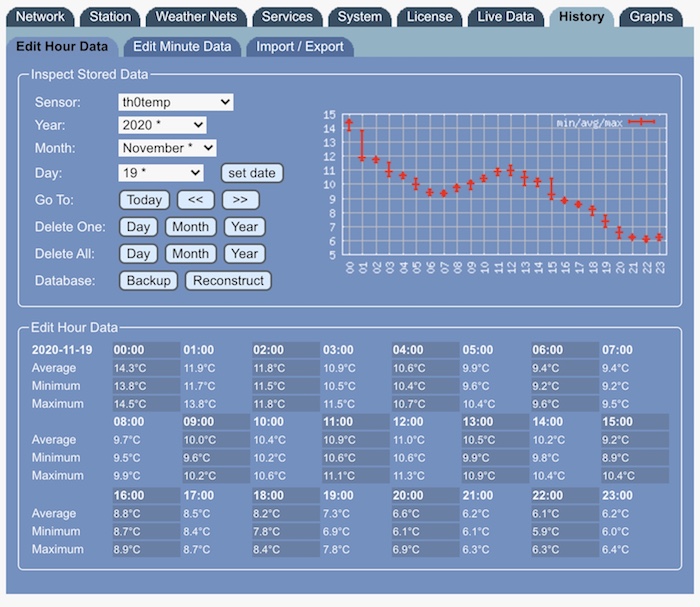

That should always work on any raspberry. See screenshot
What happens when you click on the "Edit Hour Data" tab? (Strangly it is the only one untranslated also.)
Can you make a screenshot what happens when you click that?
