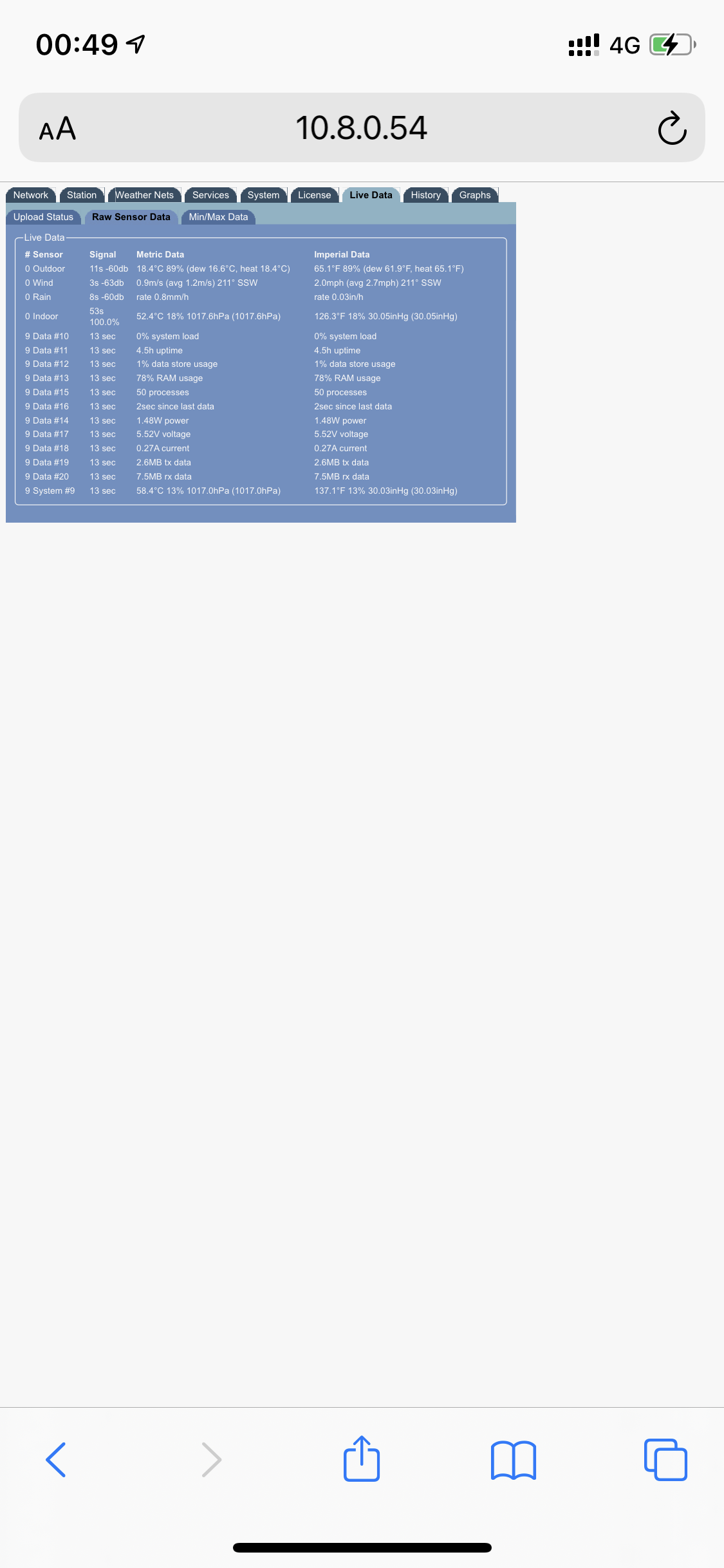

this is the raw data
- raw data
- E2F395B8-4460-4622-8D36-81755A30F54F.png (479.23 KiB) Viewed 3735 times

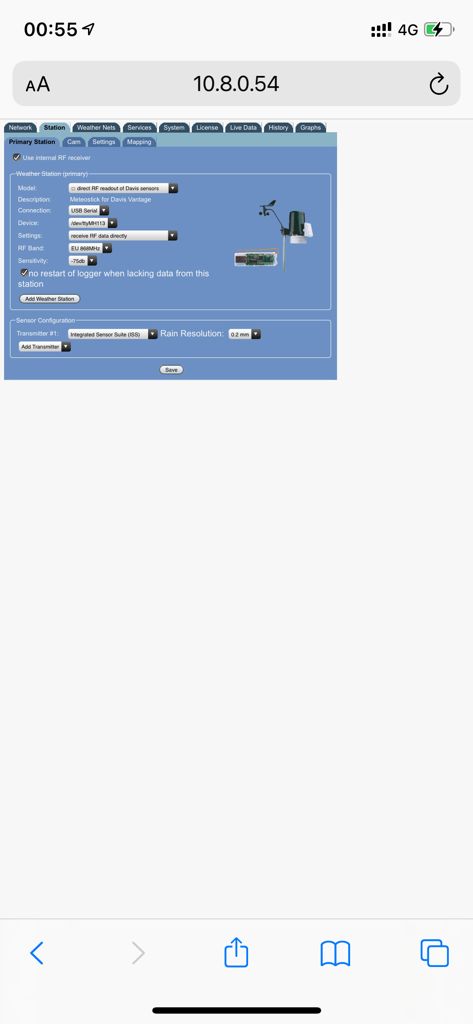

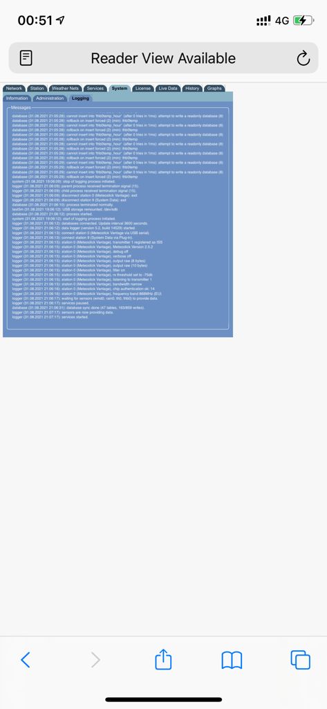

station setting and log
- DE5A00F5-3305-48F8-8805-946CB63EA252.jpeg (36.44 KiB) Viewed 3734 times
- 57A61180-497B-496F-AA57-828E0096E7CF.jpeg (26.03 KiB) Viewed 3734 times

logger (31.08.2021 13:06:02): station 0 (Meteostick Vantage), chip authentication ok: 14
logger (31.08.2021 13:06:02): station 0 (Meteostick Vantage), frequency band 868MHz (EU)
logger (31.08.2021 13:06:05): waiting for sensors (wind0, rain0, th0, thb0) to provide data.
logger (31.08.2021 13:06:05): services paused.
logger (31.08.2021 13:06:05): error while doing write on socket 5551 (9): Bad file descriptor
database (31.08.2021 13:06:36): database sync done (61 tables, 145/1822 writes).
logger (31.08.2021 13:07:03): sensors are now providing data.
logger (31.08.2021 13:07:03): services started.
logger (31.08.2021 22:51:16): station 0 (Meteostick Vantage), restart meteostick (350 secs no valid rf signal)
logger (31.08.2021 23:01:18): station 0 (Meteostick Vantage), restart meteostick (340 secs no valid rf signal)
logger (01.09.2021 01:51:23): message above repeats 1 time.
logger (01.09.2021 04:16:27): station 0 (Meteostick Vantage), restart meteostick (310 secs no valid rf signal)
logger (01.09.2021 04:21:29): station 0 (Meteostick Vantage), restart meteostick (300 secs no valid rf signal)
logger (01.09.2021 04:41:36): message above repeats 4 times.
logger (01.09.2021 05:05:37): station 0 (Meteostick Vantage), restart meteostick (350 secs no valid rf signal)
logger (01.09.2021 05:10:39): station 0 (Meteostick Vantage), restart meteostick (300 secs no valid rf signal)
logger (01.09.2021 05:28:41): station 0 (Meteostick Vantage), restart meteostick (350 secs no valid rf signal)
logger (01.09.2021 05:33:42): station 0 (Meteostick Vantage), restart meteostick (300 secs no valid rf signal)
logger (01.09.2021 06:11:45): station 0 (Meteostick Vantage), restart meteostick (330 secs no valid rf signal)
logger (01.09.2021 07:56:48): station 0 (Meteostick Vantage), restart meteostick (300 secs no valid rf signal)
