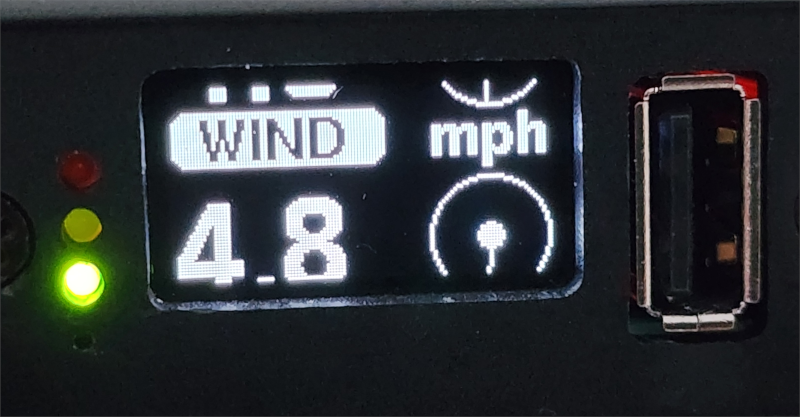

The display shifts down or up after the PRO2 is running for a few hours to a few days. Any idea's on how to correct?

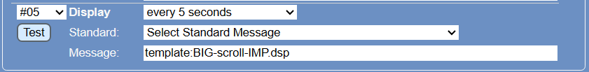

Let me test with my PRO2. Which display template are you using? Which display interval is defined?

Doesn't seem to matter what template I use. Even my home made ones have the same issue. I am currently using the built in one BIG-scrolll-IMP.dsp

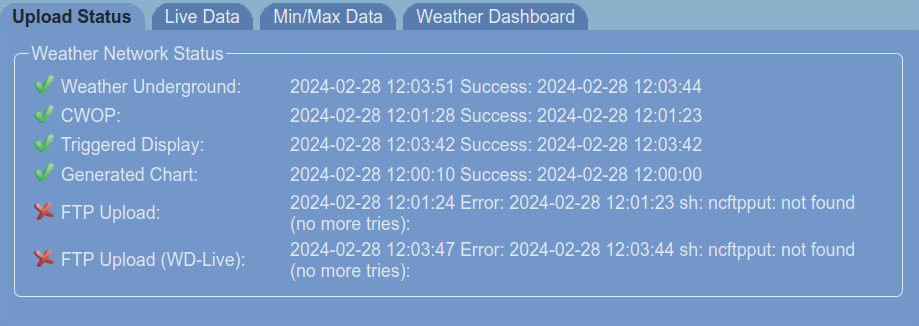

This started also. Tabs refreshing very slowly.

The intended fix seems to have some side effects. Please reboot to have the old version running again. It will need some more testing on my side.

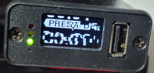

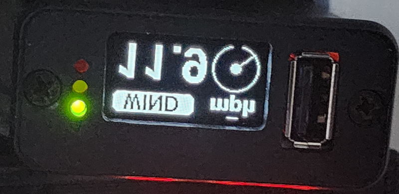

While downloading the database backup file from the SD card to the computer for safe keeping the display shows mostly unreadable. After the download completed the display shows upside down. Doing the display stop start does correct it. I purchased a new MBPRO2* which doesn't have this display issue. Could a component be getting weak causing this issue?
