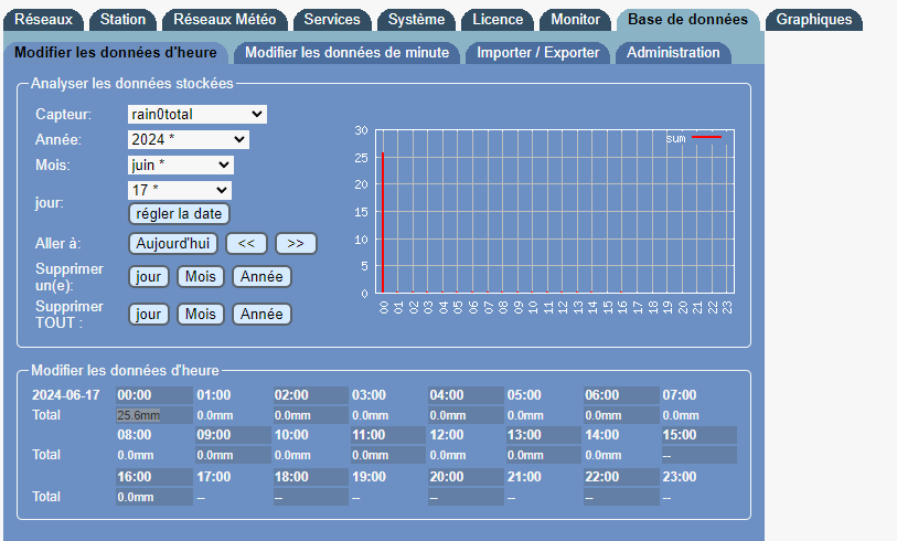

I need to edit my rain data due to a bug (25.6 mm saved but 0.0 mm in the reality).
But editing the hour data is impossible. When I click on the valur, nothing happens...
How can I edit this?
Capture d’écran 2024-06-17 161534.png (47.58 KiB) Viewed 3588 times

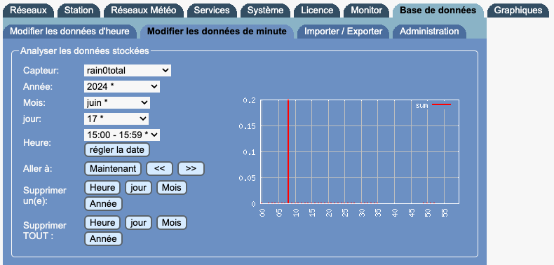

Like this:

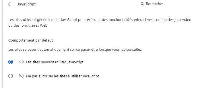

Now I'm at home... editing with IP access doesn't work
Re: Meteobridge PRO / Impossible to edit hour or minute data
javascript needs to be enabled in your browser.
oncletom17
Posts: 25
Joined: Mon Mar 11, 2024 9:38 pm
Post by oncletom17 »
admin wrote: Mon Jun 17, 2024 6:44 pm javascript needs to be enabled in your browser.
javascript is enabled
