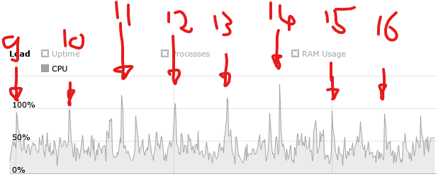

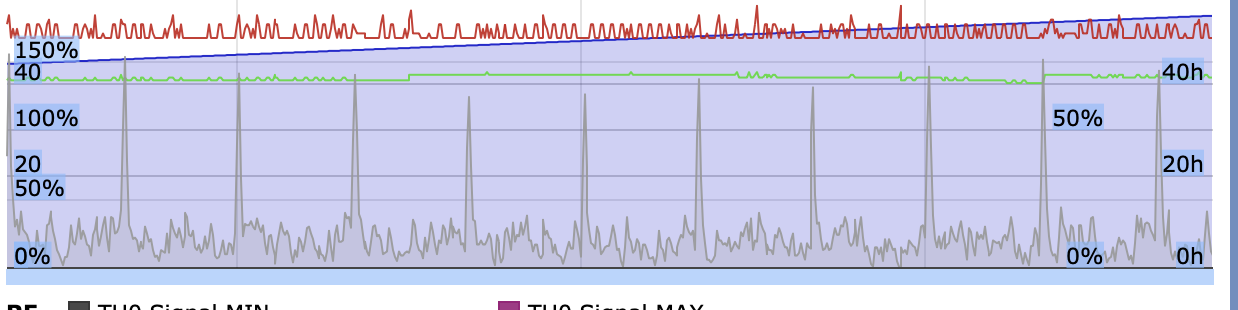

My MBP red cap CPU (grey) spikes to 153% every hour as well
yamahabest
Posts: 17
Joined: Thu Oct 16, 2025 1:11 pm
Re: MB Pro Red hanging about once amonth
Post by yamahabest »

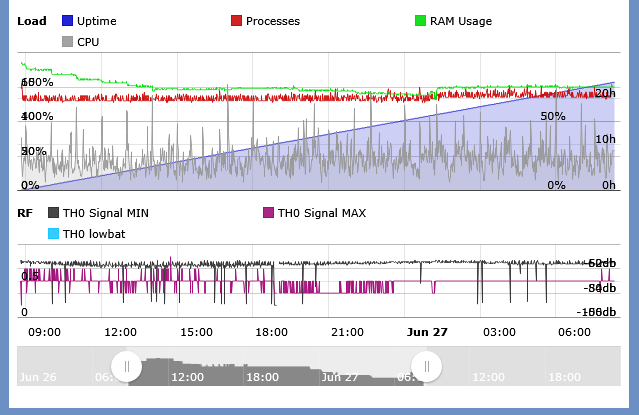

WS Heinenoord wrote: Fri Jun 26, 2026 7:22 am I'm glad to see my MB is not a sole case, but regret you have similar issues. It's very annoying because data isn't captured and uploads fail. Boris had a look, logged on to my MB and the only unusual he noted was that the MB CPU-% spikes every full hour to 200+ values. To see that for your MB, go to the "generate graph-tab" and select "MBPRO-health" graph. The cause is unclear. Switching of all events, all uploads and even disabling internet access did not change the pattern.

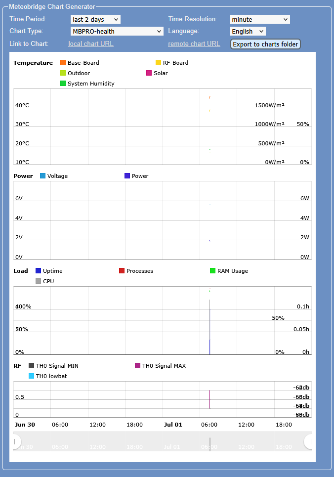

I see spikes every full hour close to or over 100%. The one indicated by 14(:00) was 137%.
At 17:00 (not in the screenshot) there was a spike of 154%.
Screenshot 2026-06-26 170353.png (40.13 KiB) Viewed 976 times

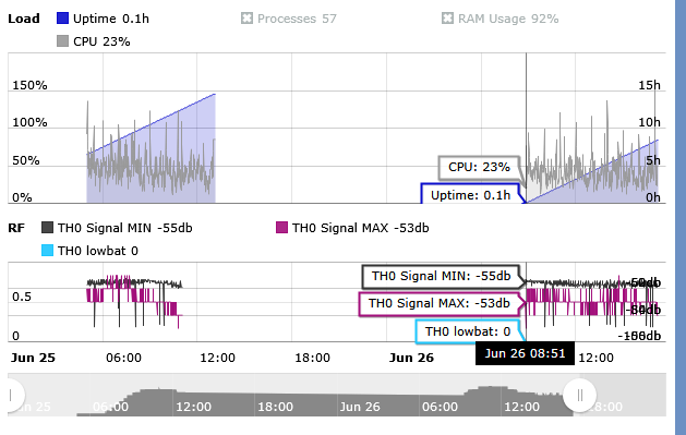

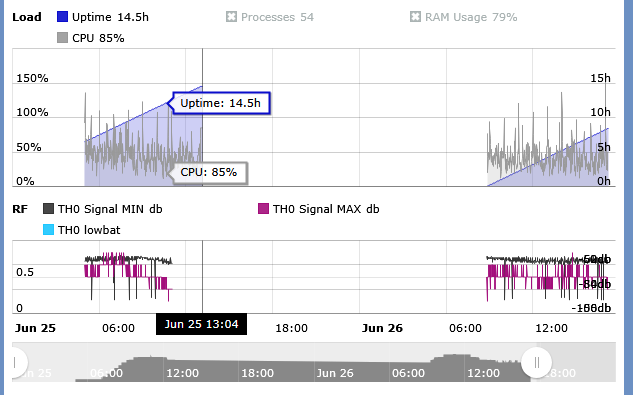

This seems also strange. I have a gap where nothing is shown on the graphs.
It is between June 25th, 13:04 and June 26th, 08:51.
Screenshot 2026-06-26 171801.png (43.37 KiB) Viewed 971 times
Screenshot 2026-06-26 171943.png (49.23 KiB) Viewed 971 times
But while this occurred, WOW was fed data without issues:
Screenshot 2026-06-26 172705.png (34.96 KiB) Viewed 971 times
What can also be seen is that somehow the RF already stopped at around 11:04 (on the 25th), and resumed at around 13:05.

yamahabest wrote: Fri Jun 26, 2026 5:06 pm
Can you also show the corresponding Processes & Ram usage

This is the current view:

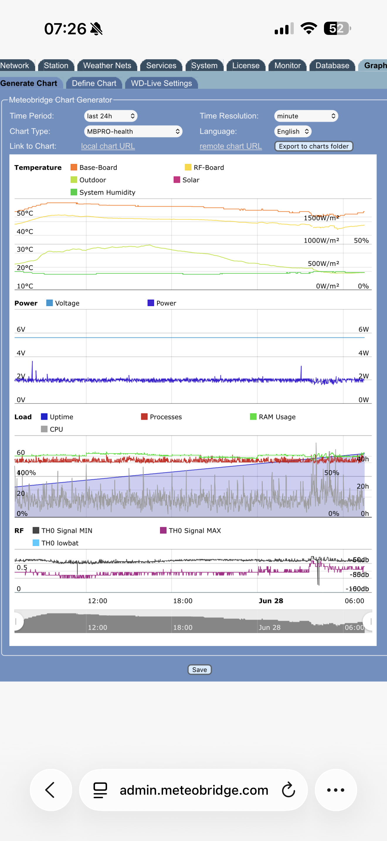

Screenshot 2026-06-27 082029.png (81.71 KiB) Viewed 945 times

System seems unstable to me.

On the WOW system I also see gaps of 20-30 minutes, with no data, around these timestamps.
There are also some CPU spikes (above 100%) around these timestamps:
plex
Posts: 95
Joined: Tue Nov 30, 2010 1:01 pm
Location: Denmark
Post by plex »

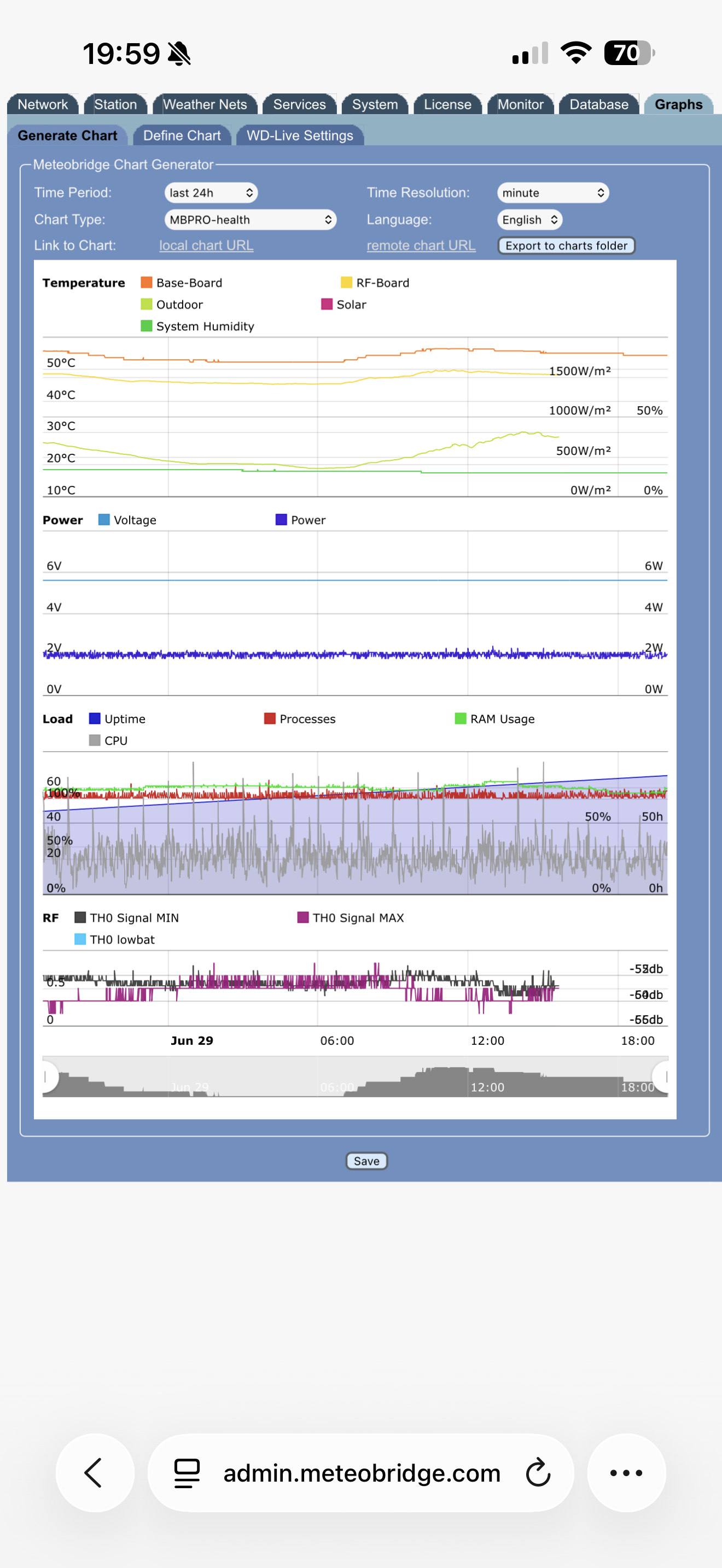

So mine just crashed again... Hour before CPU was peaking at 169%.
So as I understand CPU should not have hour peaks like this?

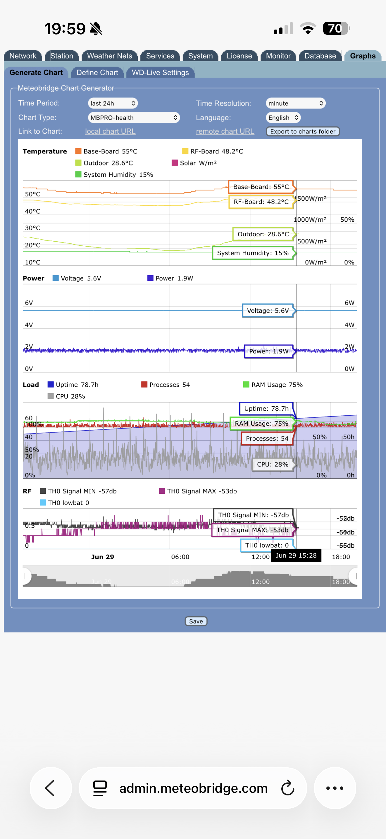

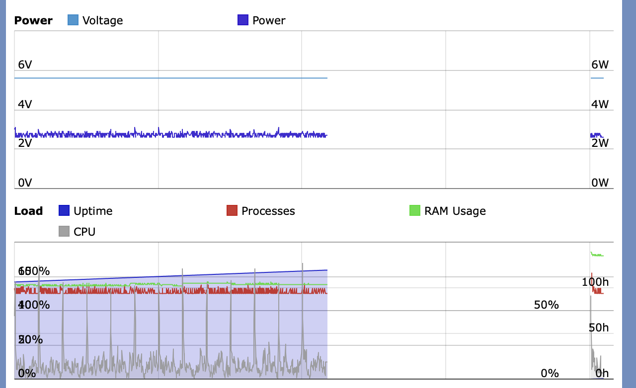

The system is once again not receiving data.

I had another hangup.
Video of what the MB Pro is showing:
https://youtube.com/shorts/u5RvaMgcOs0
Screenshot from router:
Screenshot 2026-07-01 073453.png (10.11 KiB) Viewed 839 times

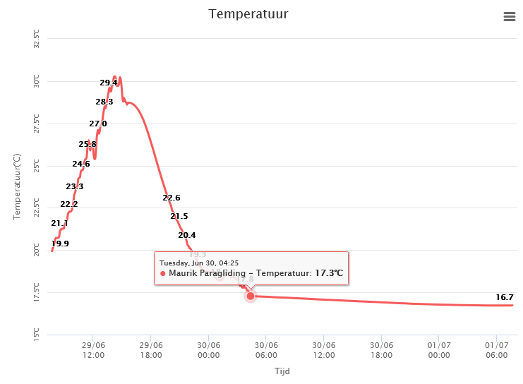

There is nothing in the graph (anymore, whilst it goes back to midnight at June 30th):
Screenshot 2026-07-01 073930.png (41.59 KiB) Viewed 839 times
No data for more than a day:
Screenshot 2026-07-01 074249.png (29.44 KiB) Viewed 839 times
